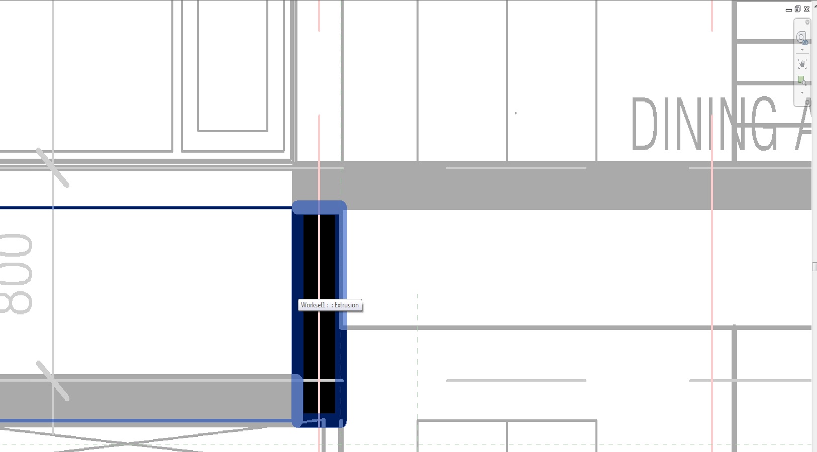

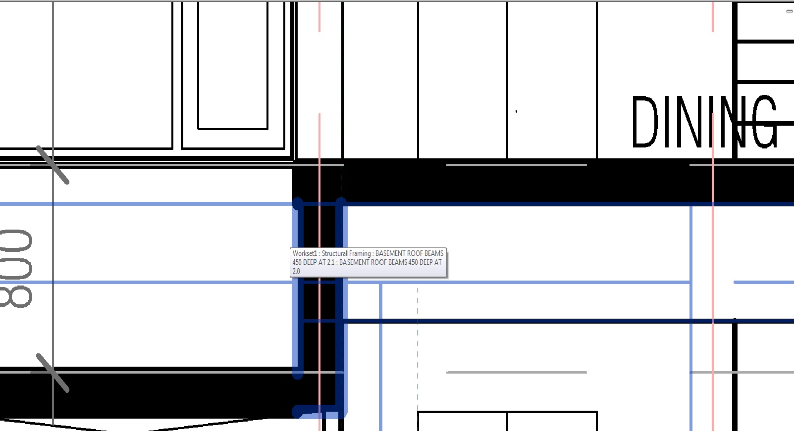

Hi,
The one major problem i have faced is controlling object style and line weights.
I have modelled my beams under "structural framing"
by default its cut lineweight was 2. but in object style i changed it to 5. but i cant see any change in my sections.
wierdest part is this- when i "edit in place" the cut lineweight changes to 5!
attached images of the problem.

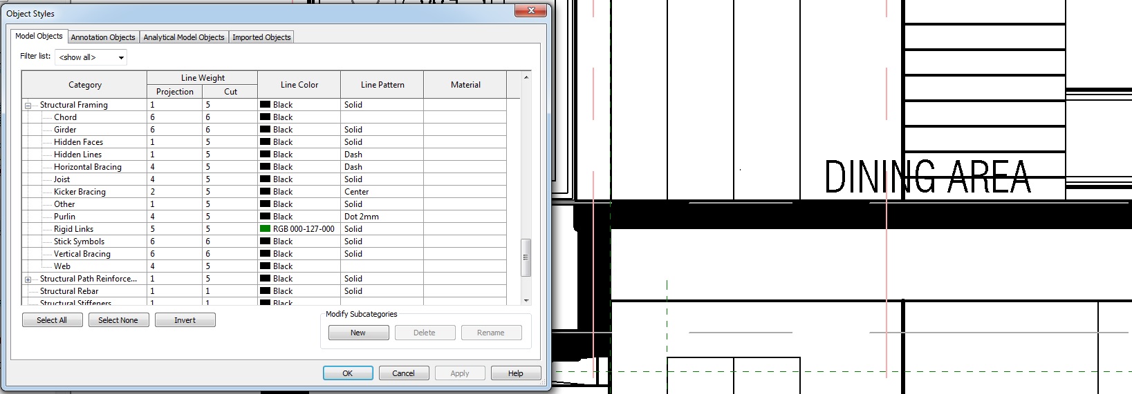

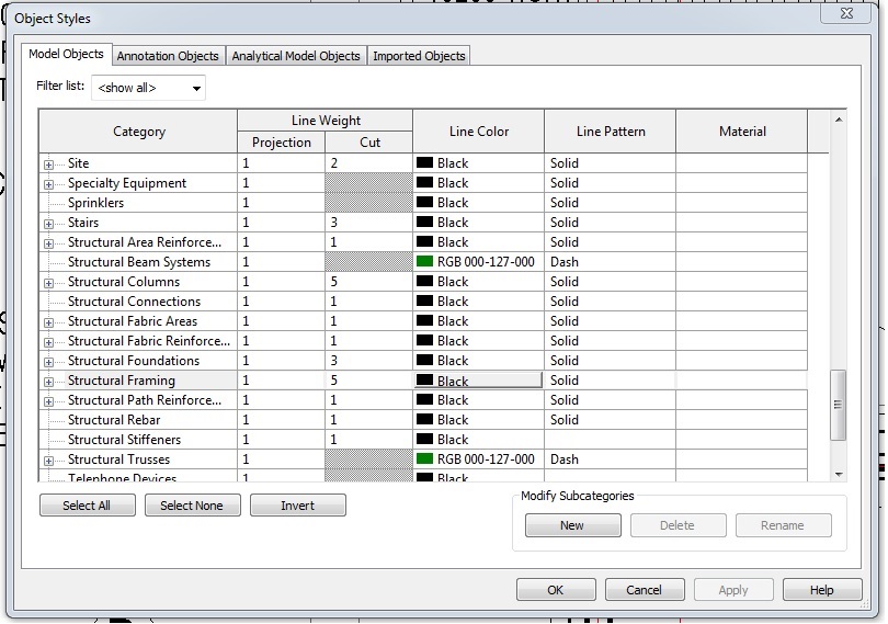

Is your object assigned to any of the structural framing subcategories? If yes, you need to expand struc. framing category in the object style window and change that subcategory.
Fri, Jan 30, 2015 at 12:08:48 AM | OBJECT STYLE ISSUE
sud12
Joined: Mon, Oct 27, 2014
0 Posts
5 Stars: 1 Votes
CHANGED ALL SUBCATEGORIES TO 5.. STILL THE SAME PROBLEM

Hey Sud12,
Just wanting to check, have you got thin lines turned off?
Short cut is 'TL'
Also, try changing the projection lines to the '5' line weight.
