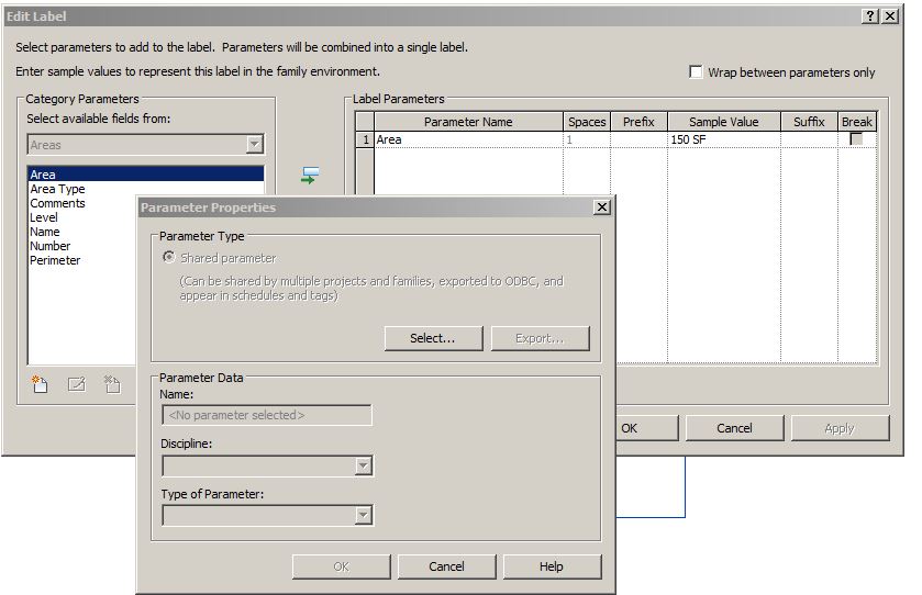

I would like to replace the actual square footage of the room (which is the default) with the rentable square footage (RSF), which is often a multiple (of a factor) of the actual square footage. For example if a room is 976 square feet, the rentable square feet (RSF) factor (in this example) is 1.18, so here you would multiply the 976 by 1.18 and get 1152 square feet. In other words, the equation is RSF = SF*1.18 = 976*1.18 = 1152 SF
How do I create the parameter of RSF and show it as a value = a multiple of the SF, then create the tag so that instead of the "Area" tag i use the "RSF" tag? I'm having a lot of trouble creating the parameter itself.

Perhaps you don't understand.  Our English language is bad sometimes.  You can have 'area' - a quantity and 'area' - a space.   If you notice, the halp says you can add shared parameters to 'areas', meaning the space term.   Area plans are seperate from floor plans showing rooms.  When I first read your original post, I thought you meant room areas.
So - here is the process to follow:
  1. Open your shared parameter file or create one.   (We have several office files and sometimes ones that are project ones that are stored with the project.)  (You may want to do this in process 4 - below)
  2. In that file, create the shared parameter (and group if needed).
  3. Close the file.
  4. Edit your area tag.
  5. Under the manage tab, pick your shared parameter file (or create it)
  6. Add a label -
  7. When you see the image below, click on the lower left icon that has the colored asterick
  8. Add your parameter to the tag.
  9. save your tag (maybe with a new name?)
  10. Load the tag into the project

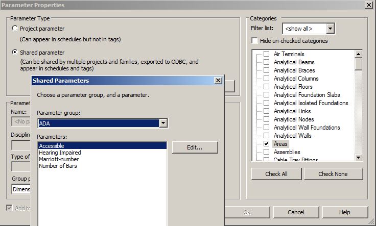

  11. While in the project:
  12. Set the pointer of your shared parameter file under the manage tab
  13. Under manage tab, pick project parameters, then add
  14. Now you will see the second image where you pick your shared parameter and your area category.
Now when you click on an area, your shared parameter will be there for you to fill in.   BTW - I would think you knew to set this as instance based....
