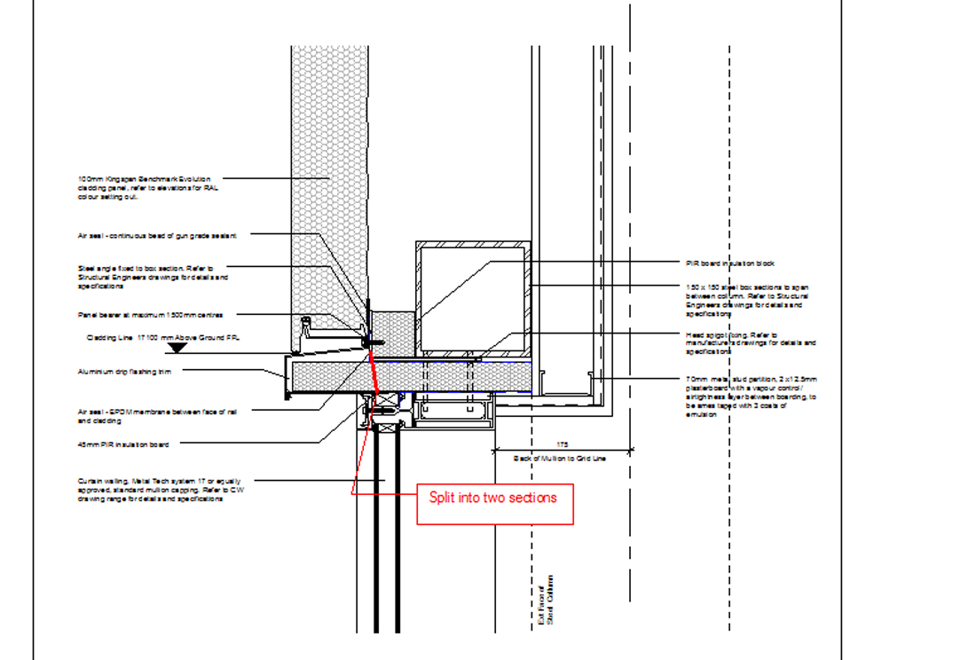

I have exported a variety of views from Revit to use within a group discussion. Using Autodesk design review to add comments and lines, once completed I saved as Dwf and intended to import this back into Revit.
When I import a variety of sheets, the notes dont align, where shown on the marked up dwf. As these are pinned you cannot adust these notes, and really, aligning each sheet defeats the purpose.
Has anyone come across this before?
The first markup is located correctly. But the rest of the sheets the mark ups are way off where they should be.

Yeh this is very strange.
I have attached an image to show you how I have set up the export.
Also, added image to highlight the effect from Autodesk Design Review and Revit.
So to reiterate once exported, I have drawn over and commented on several sheets in Autodesk Design review. When I import this back in as a dwf markup to Revit the additional notes go onto the allocated sheets but are not aligned correctly.

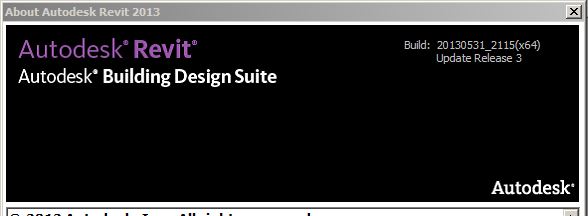

Thu, Jan 22, 2015 at 7:27:28 AM | Dwf Alignment Issues
Moving the file should not do anything as you discovered.
So by up to date, you mean you have all 3 updates installed for 2013 - correct?- see image
We have seen too many users who say they are up to date and they are not.

Yes, I have this exact information in this dialouge box.
All updated have been installed.
Thu, Jan 22, 2015 at 9:52:13 AM | Dwf Alignment Issues
I wonder if this is a video card issue.  If it works ok in 2015, then we know it is something else.
