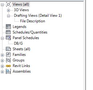

Hi guys,
I am looking to edit an MEP model of a building. I have the Revit 2014 version with Architecture, structure and Systems combined.
I have the MEP, structural and architectural models individually. How do i link all together and only edit the MEP. The MEP model shows no floor plans, sections or elevations in the project browser. Only the 3D view.
Please find an image to show.
Any pointers or step by step advice would be much appreciated.
Thanks
Andy
Wed, Jan 21, 2015 at 7:45:51 AM | Editing an MEP Model and linking with Architectural Model
Who created these files?   They are probably already linked.  You can learn all about linking files by reading your help and I'm sure there are some on-line videos as well.

Link by view would be a good place to start researching
