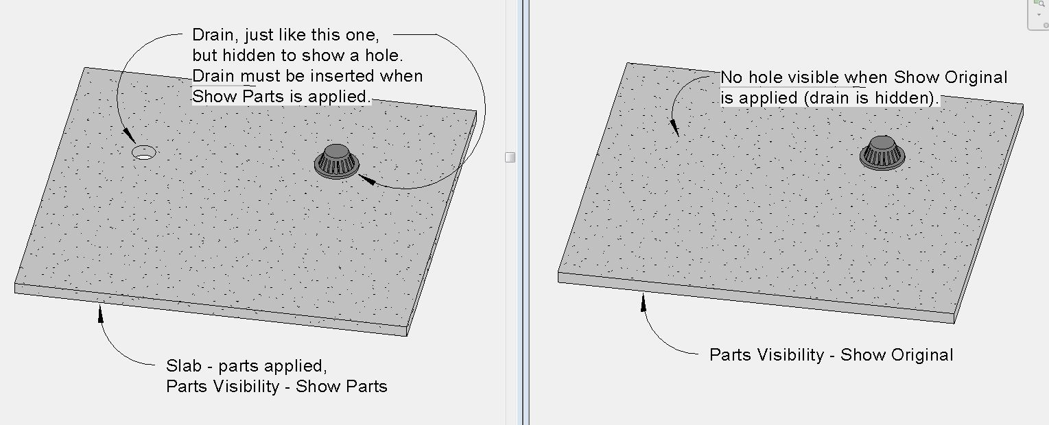

Try playing with parts. I’ve never done this before, so I can’t tell you of any pitfalls down the road, but it looks like you might be able to achieve what you’re looking for using parts.
Turn the slab into parts, set the visibility to show parts and insert any drains, recesses, etc. When switching parts visibility to show original, any slab cuts will not show. Hope it works for you.

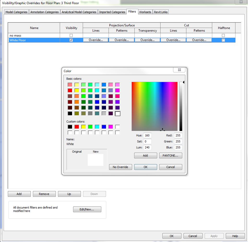

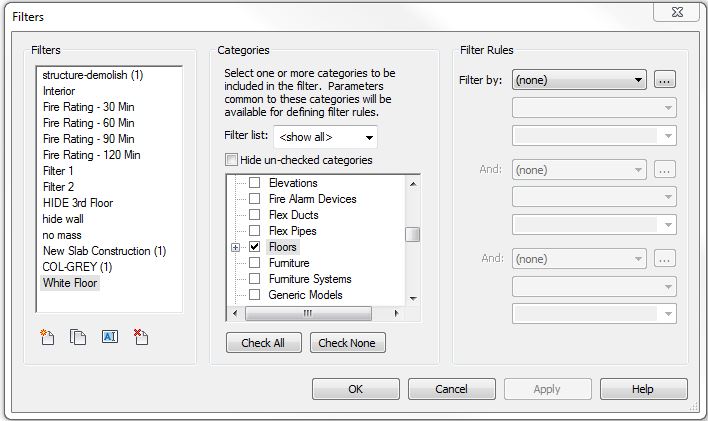

I had this very problem and solved it by creating a filter -
If you 'override the graphic in view' for floors - by filter - and Override the 'Lines' (projection/surface) to be shown as White, it hides the slab edge of floors.
Views that you want floor slab edges hidden - apply this filter.
Hope this helps.
Fri, Aug 28, 2015 at 9:25:10 AM | Hiding slab edges in the middle of a slab
ajaichohan
Joined: Tue, Mar 29, 2011
0 Posts
Forgot to add, if you just want selected floors to have their edge's invisible, edit the filter created by 'mark' and assign the same 'mark' to the floors which require edge's to be hidden.
