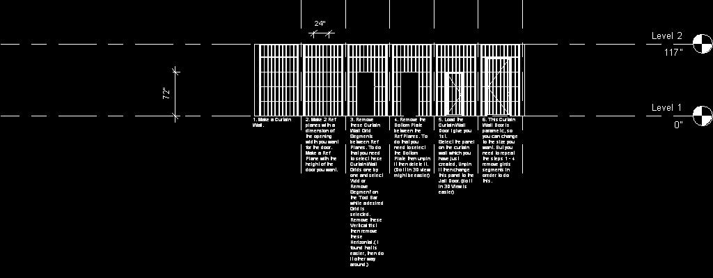

The Attachment here is the Jail Cell Door. I also created an example to show you how to use it step by step in the next thread. Download them both and have a look of the example.

Here is the Jpg Image to show you how to use it step by step. Post edited on 2006-03-25 20:02:26

Here is the example of the Jail wall and door in Revit.
