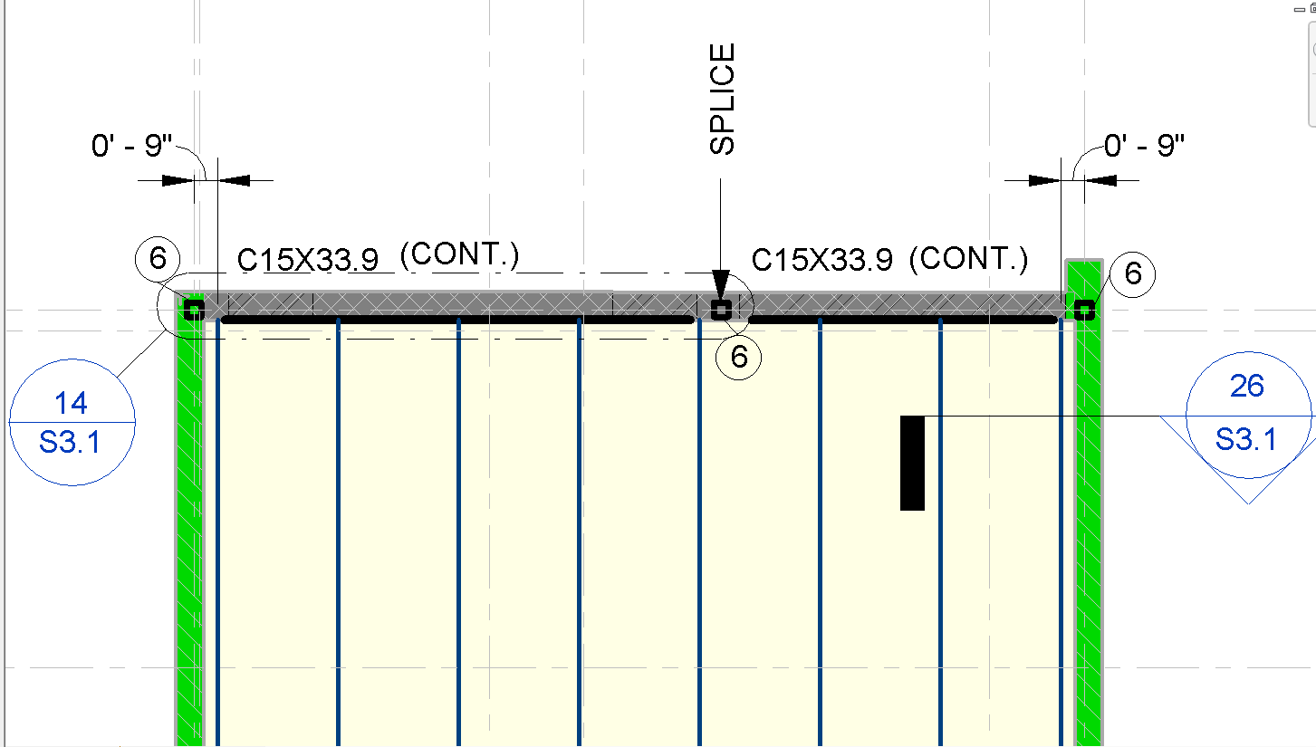

I am working on a project with multiple links. I am using the architects model to show walls, and their model linked within mine has a hatching in the walls. This is interfering with a hatch I am using to show Headers. Is there a way to turn of the linked wall's hatch?
Thanks,
KraigZ
Thu, Jan 8, 2015 at 3:59:03 PM | Linked Walls Show Hatch
You can control the linked file's walls in VG under the linked tab.

Thank you I figured it out!!
