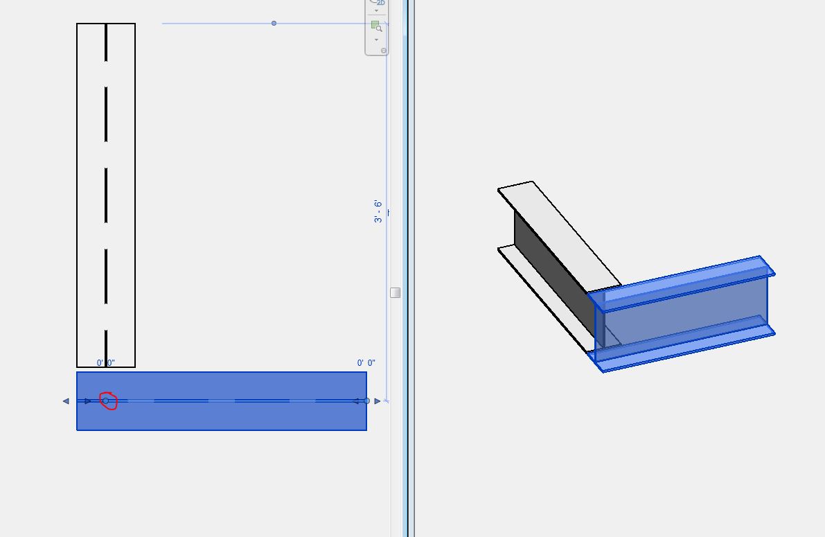

i'm working for a structural steel fabrication shop and i'm trying to convert to Revit, re-taking a class soon -its been a few years.  i can do it in CAD in my sleep.
i have a steel frame made of 3 -W4x13 beams, 2 upright columns & 1 horiz. beam and the client wants to miter cut them all and weld but i can't get Revit to do it, please help.

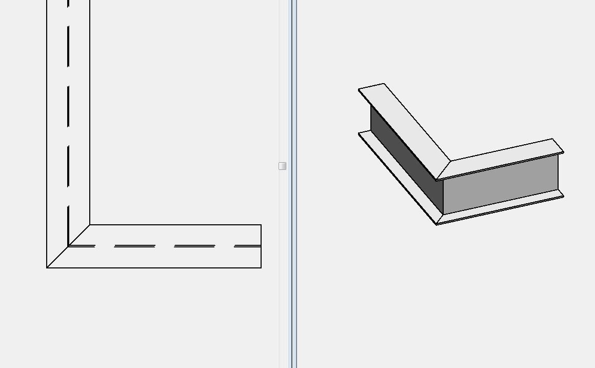

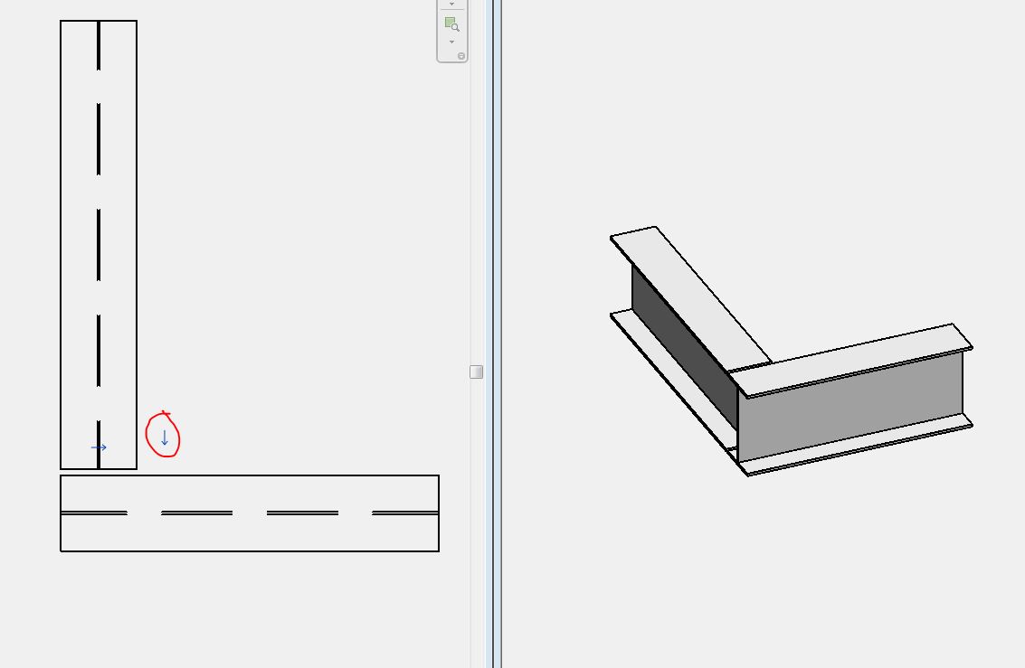

Select a beam, right click on the blue dot and pick ‘edit beam/column join’ and click on the blue arrow. I’m not sure if that’s what you’re asking for though, some screen shots of what you're after would be helpful.
