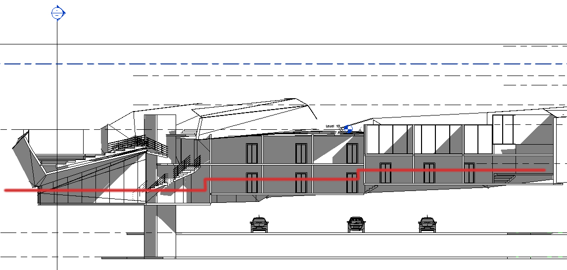

Hi everyone,
i have a problem with my project that i can't make a "Main Plan View" That shows me all the slabs in ground floor included landscape..
How can i make a "Plan View" like the red line in the picture ?

Your question is not clear.  The image you show is a section not a plan.  If you want to see your slabs you need to make sure they are turned on in the view under VG.  If you want your section to crop like the red line you have drawn then you can click on the crop box and under Modify, Mode panel select edit crop.
Wed, Jan 7, 2015 at 8:39:12 AM | Make a refracted "Plane View"
Read your HELP  - search:  Plan Region
