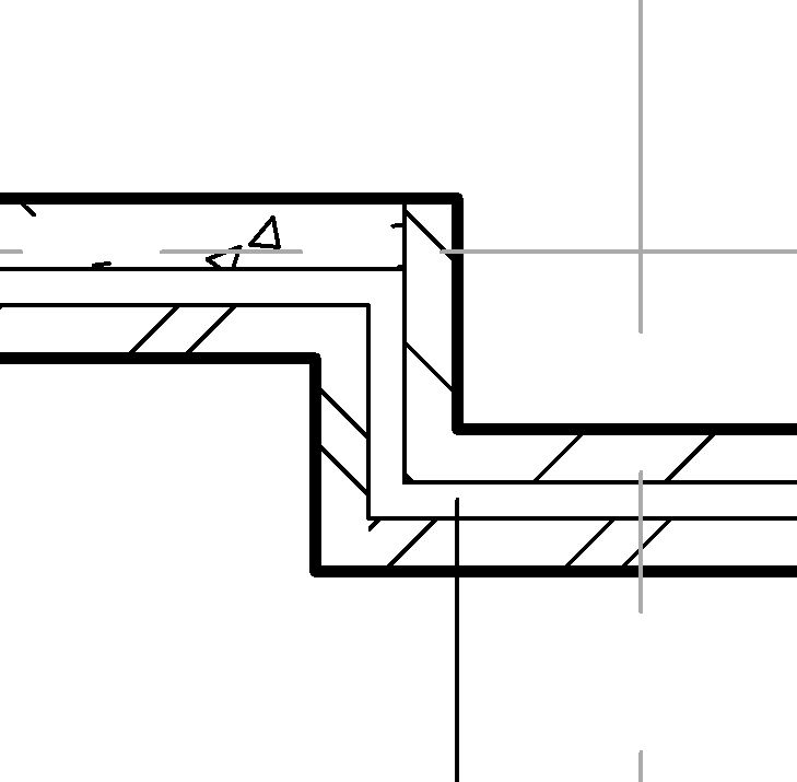

Is there a way of overiding which internal wall of two different cavity walls takes preference? I have a block / brickwork cavity wall and a rc wall / brickwork cavity wall. I want the rc wall to extend where they meet at a corner but it seems the block version wants to take priority. See attached image.

Just found out how to achieve this! By changing the function of the inner block wall from structure [1] to substrate [2] in the assembly edit.
