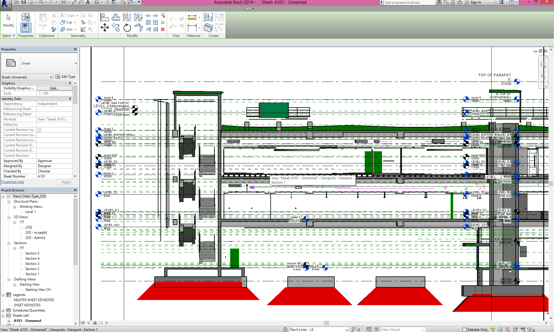

i want to make a section which is not straight line, but in curve so, i have cut two sections and in sheet i have joined these but my problem is its showing level on both side, and i cannot switch off these because section is cut through linked file. what would be the solution. Thanks.

Your image is meaningless and you can not cut a curved section.
Linked file elements can be controlled seperately in VG.   Turn off the linked file levels and use your's.
