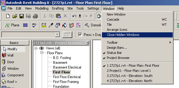

Revit Tidbit When you find yourself with multiple projects and views open and need to close all views except the current views. don't forget the ever handy - Close Hidden Windows. From the Revit menu bar pull-down select Window ===> Close Hidden Windows This will close all views in all projects except the current view in each project Post edited on 2006-03-14 09:49:01 Post edited on 2006-03-14 10:55:35

Wed, Jul 22, 2009 at 2:55:54 PM | Revit Tidbit - Close all open windows
velvetseas
Joined: Thu, Nov 6, 2008
32 Posts
I loved that feature.  Is there something in Revit 2010 that does the same thing?  If so, I haven't been able to locate it.
Wed, Jul 22, 2009 at 3:44:40 PM | Revit Tidbit
alabaster2513
alabaster2513 Avatar
Joined: Tue, Jan 16, 2007
1009 Posts
3.5 Stars: 25 Votes
It's under the View tab - Close Hidden
Wed, Jul 22, 2009 at 4:04:53 PM | Revit Tidbit
velvetseas
32 Posts
Obviously I didn't look hard enough.  Thanks, alabaster!
