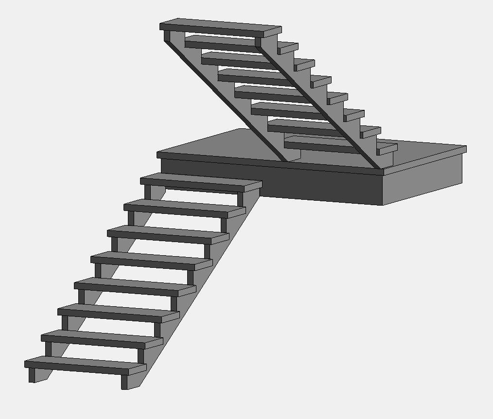

Hi,

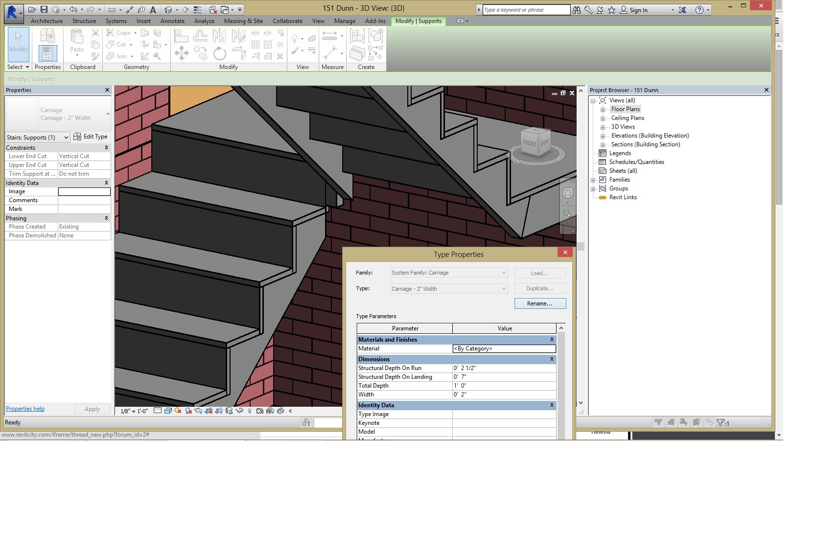

I cannot get the carraige to join the landing between two runs. The right support side is working fine, but not the left. I cannot change the upper end cut, it is greyed out for some reason. Any help with this is much appreciated, since this is a fire escape stair and once I remove the risers it looks as if the left side is floating in the air. See pics below. Thanks for any help ahead of time.

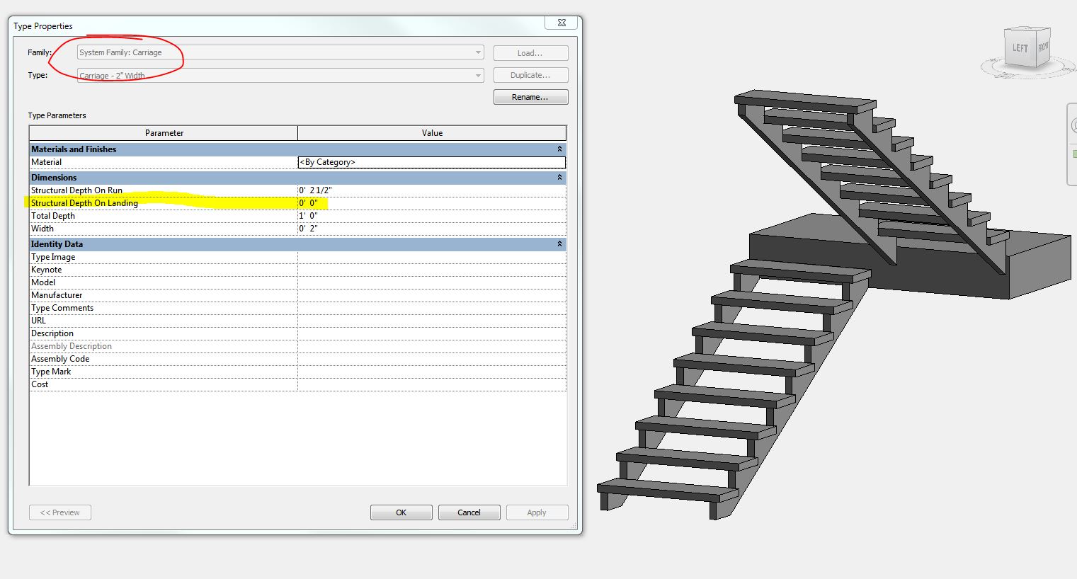

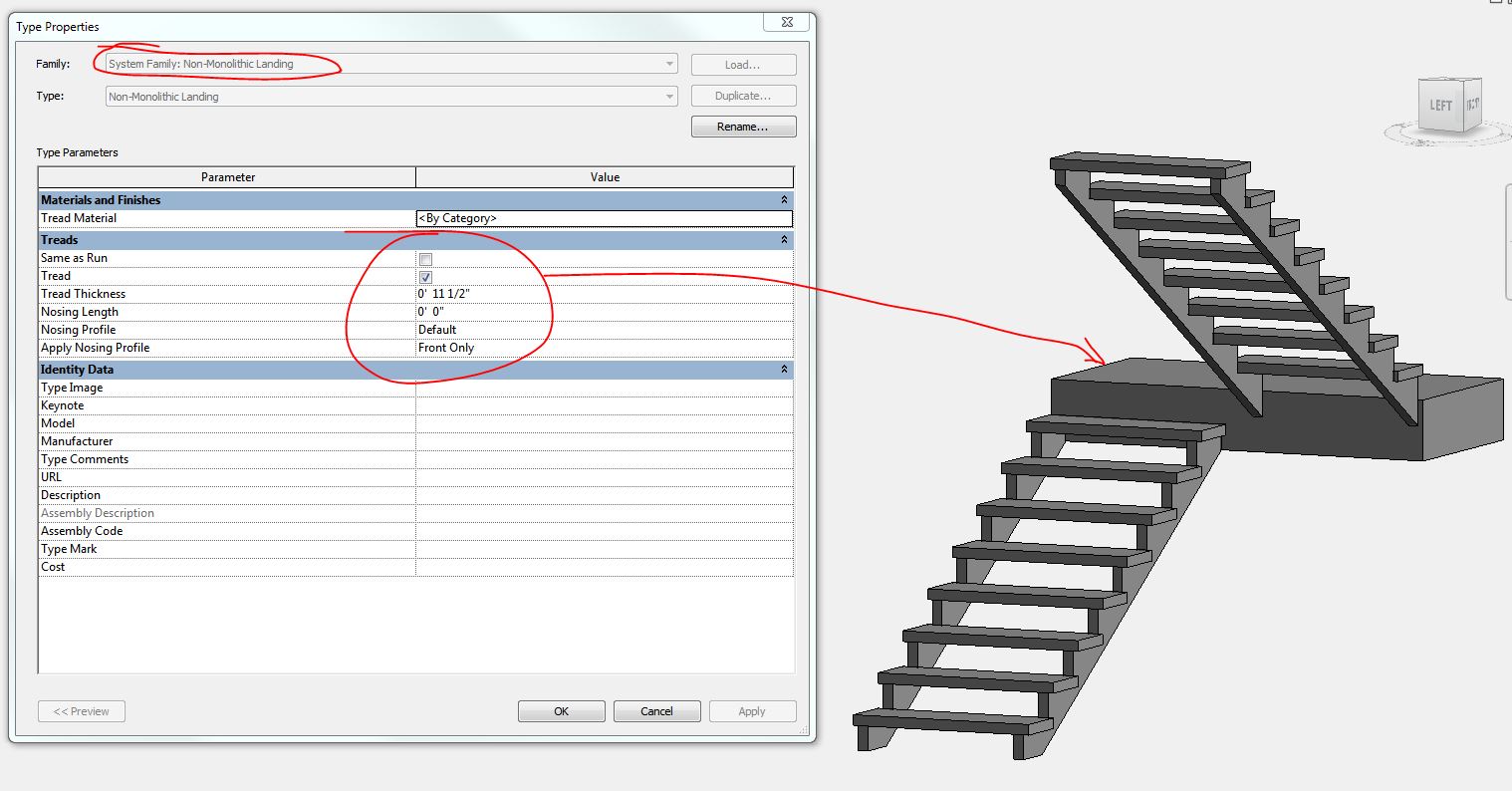

You can sort of make it work by removing the carriage from a landing (pic 1) and turning it into a tread with some thickness (pic 2). Or, create stair out of 3 separate components – 2 runs and 1 landing/floor (pic3). Hope it helps.
