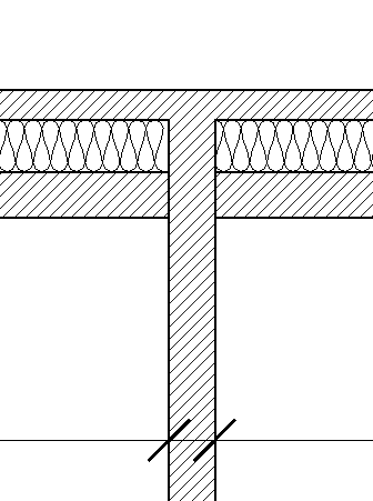

Hi,
I can't figure out why the inner walls of the house keep overlaping the outer walls.
Any help is welcomed.

The core layer will join with the core layer of the second wall. See this and this for more info.

The second link did the trick. Thank you Smile
