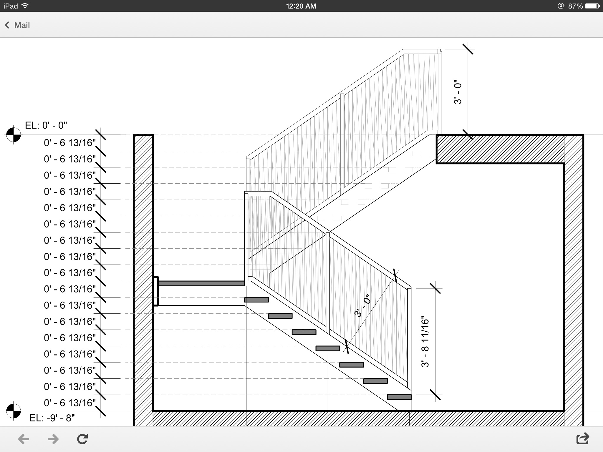

How would you approach modeling this railing? The tricky part (for me) would be the weave in between the balusters, that is supposed to be a single cable filling each panel. It would be best if it were parametric so we could look at different configurations quickly. I.e. Weave separation, baluster height etc.Edited on: Tue, Dec 9, 2014 at 2:38:52 AMEdited on: Tue, Dec 9, 2014 at 2:39:10 AM

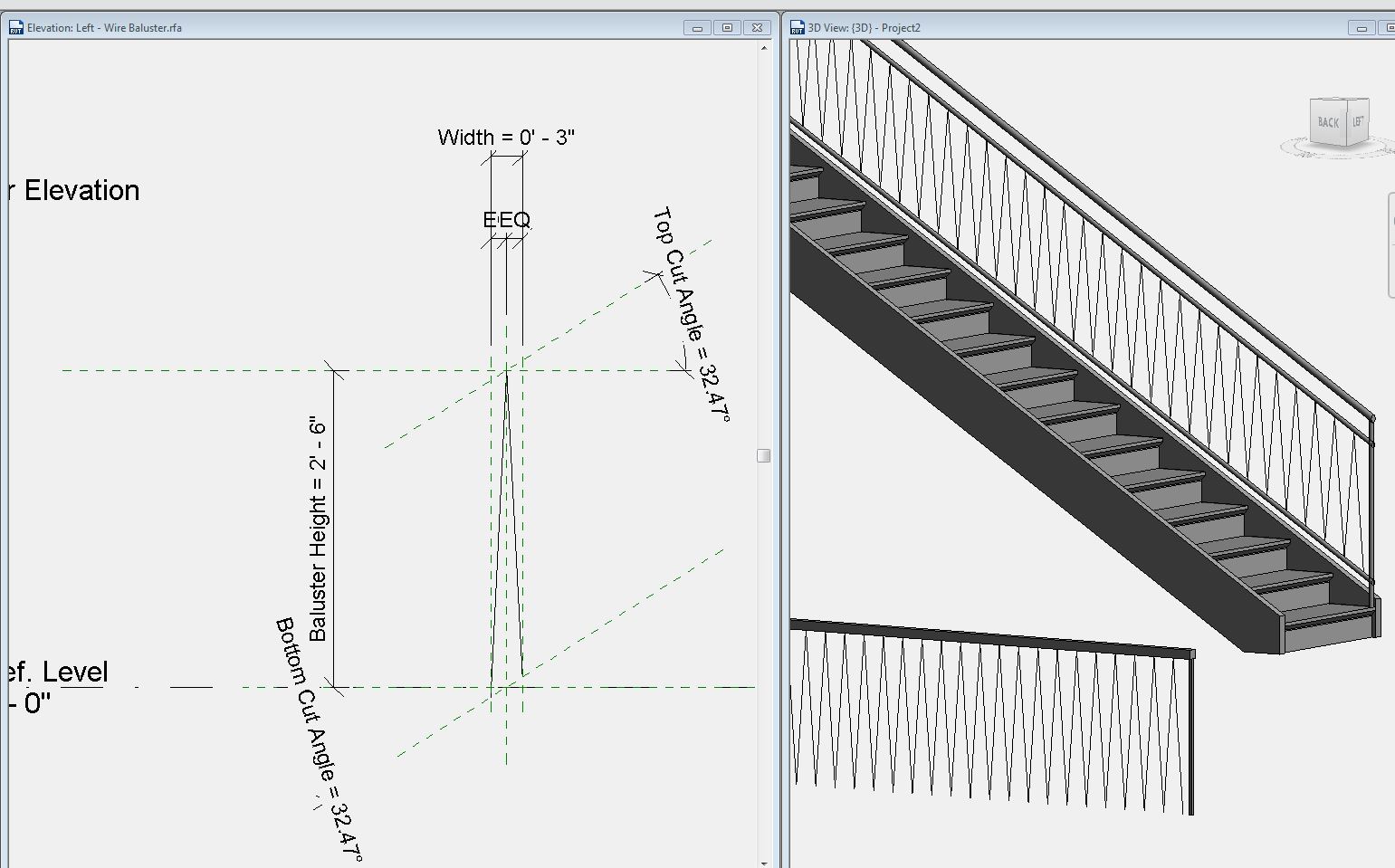

Image 2

Start with the Baluster template. You can use model lines to represent the wire. Create a few family types with different spacing, so you can swap them in the project.

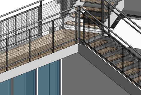

Can you find that maybe in a material?
That's what I used for these Mesh panels.
