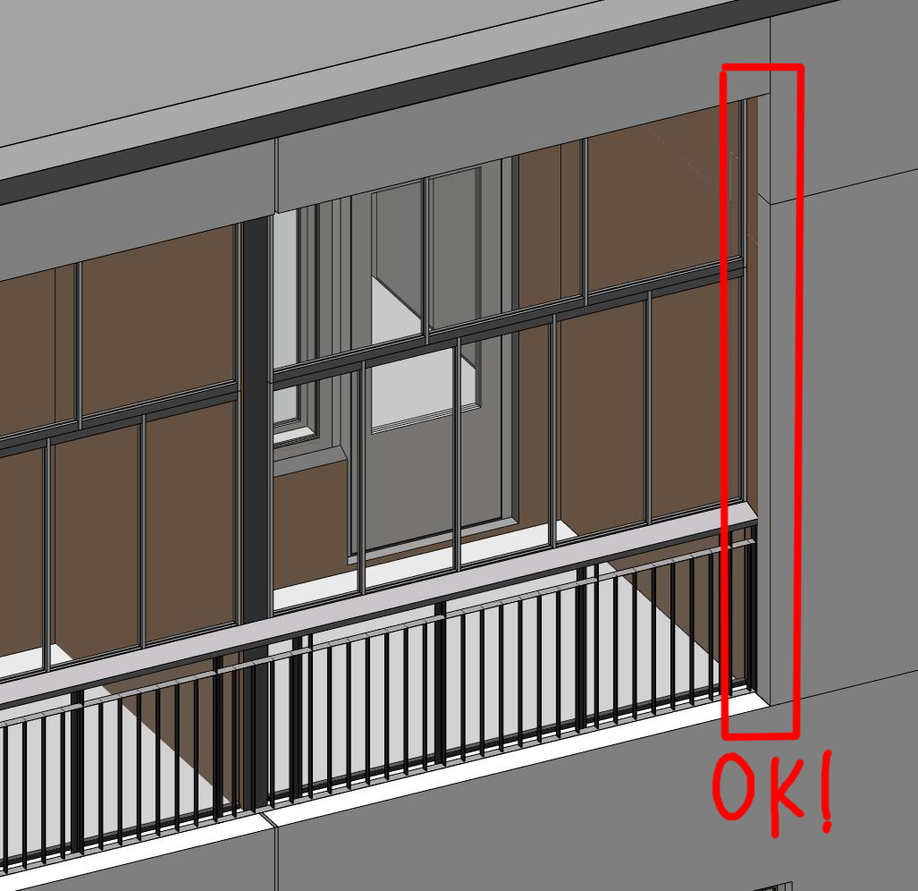

I have question regarding wall wraping at wall ends in Revit 2013

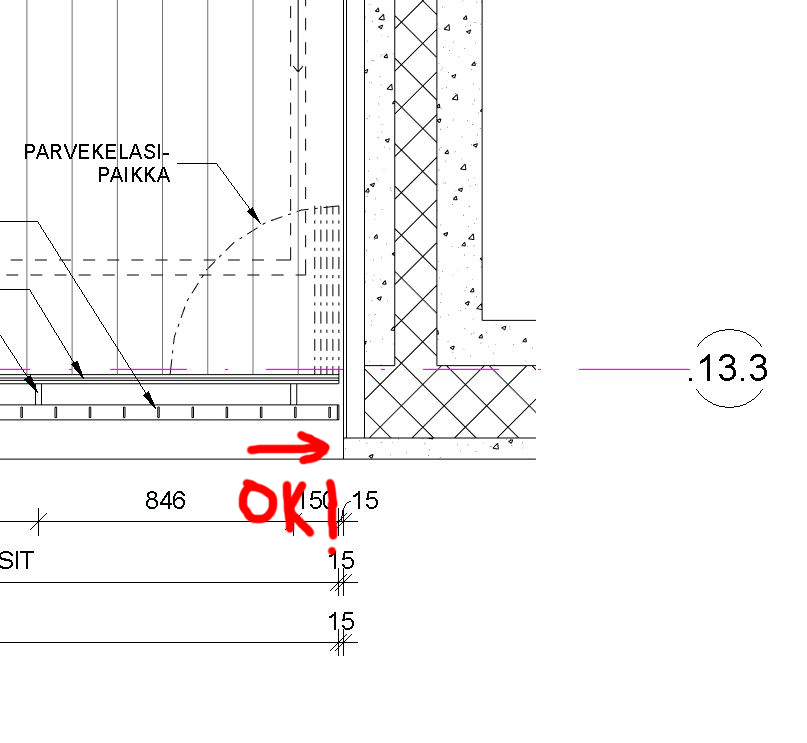

As you can see in the images I´m joining two diferent wall types, and in plan view they look ok.

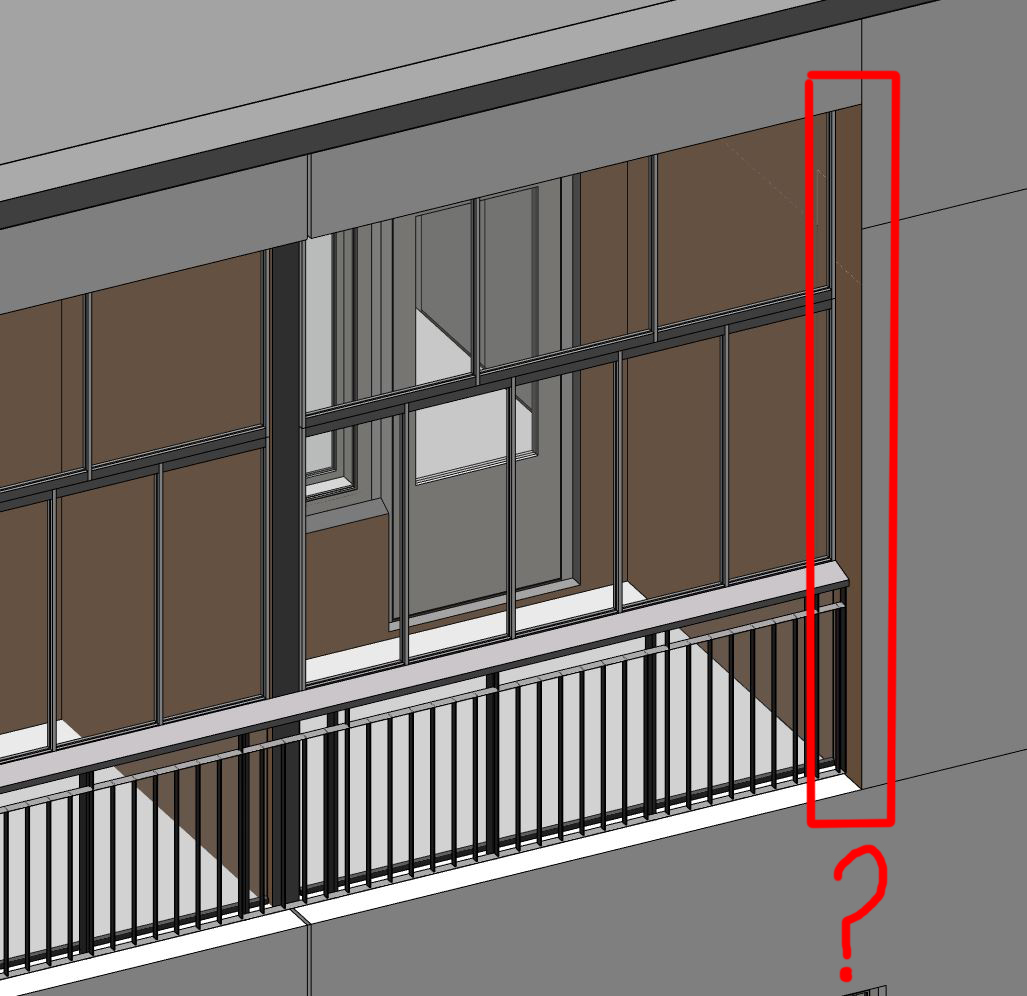

The problem is that in the 3D view the white wall should wrap a bit so that the end face is visible on the side but for some reason it doesen´t.
The thing is that I need this to look ok also on 3d because we are rendering with 3dsmax.
In other more visible corners I create a splitface and just add that wall end but thats labor intensive and every time I edit a window or anything related to the wall the splitface disappairs.

Maybe the plan view is confusing but those are two walls joined at 90 degrees, nothing special about them but the fact that they are two different wall types with different layers.
They are joined correctly in plan view (almost) so it´s not a joining problem. The problem is with how that joint is displayed in 3d.
What in plan is displayed correctly as a butt joint in 3d is displayed as a miiter joint.
I´ve done a quick photoshop of what I get and what I should get on the 3d view.
Is that the only way Revit does the joints on 3d or there is something I can do to make it look right.

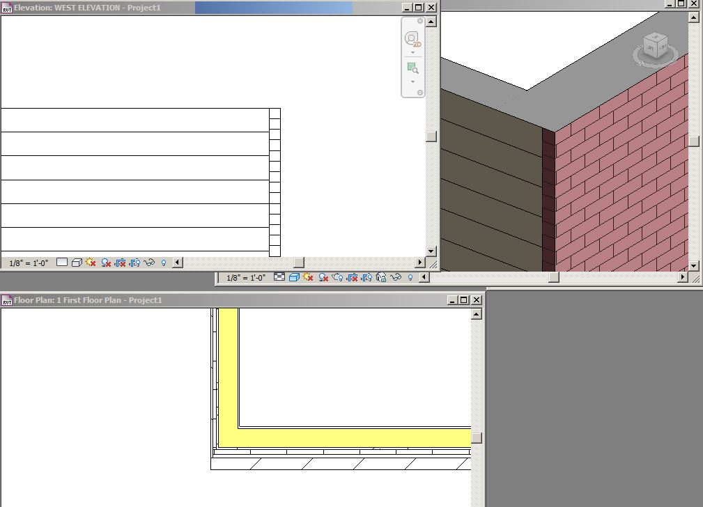

I think the parts is too much work for the results.
If the layer priority is set correctly in th wall types, then the plan will correctly show the layers as mine does in the attached.   The problem is the brick doesn't show on the end in my scheme.   The fix is to split the face and paint the finish on that end.   Easy fix and fixes the elevations and 3D.
wrap exterior face of wall at ends as an instance not a type parameter
