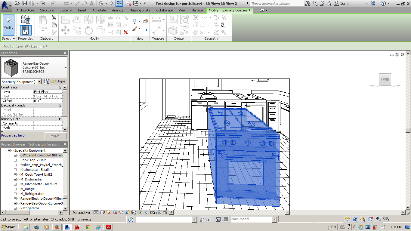

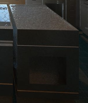

Why isnt my Range top, knobs and door handle not showing in my renderings? After I load the family and select it, I could see that the Range Top, knobs and door handle are there (see attachment). For some funny reason after I render it (see attachment), it looks like as if the Range Top is hidden in a white block and the knobs and door handle disappeared.
I also made sure I followed their instructions on where to store the materials, which is:
C:\Revit Manufacturer Library\Specialty Equipment\Dacor\Materials
To see the exact stove I downloaded:
http://seek.autodesk.com/product/latest/agg/dacor/Dacor/Dacor22
(You may even try downloading and rendering it to see if you get the same results)
Please somebody help me,  why isnt the Range top, knobs and door handle not showing???
(See attachments)

You need to set your view to fine detail level.

God has nothing to do with it …lol, it’s just the way this family is built.
...and it’s quite easy to change it to work in other detail levels as well (if needed).
