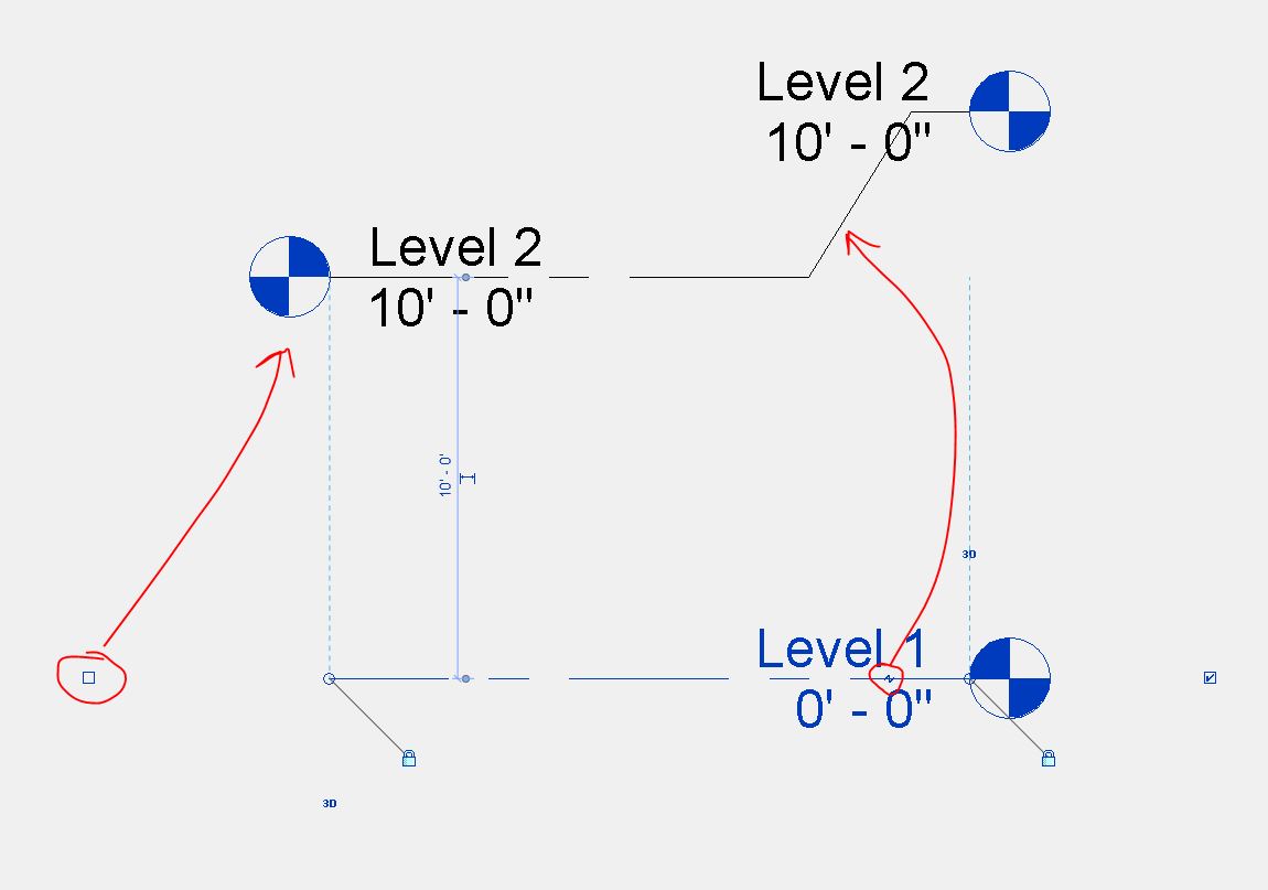

I am brand new to Revit- Just learning- I am starting a house that has 3 levels (with corresponding foundations & footings) the levels are very crowded & I was wondering if I can mirror some of them so they more accurately correspond to the side of the house that they occur. If I can- how do I accomplish this. Thanks

See picture - should be self-explanatory.

Thank you!! Your diagram was excellent!
