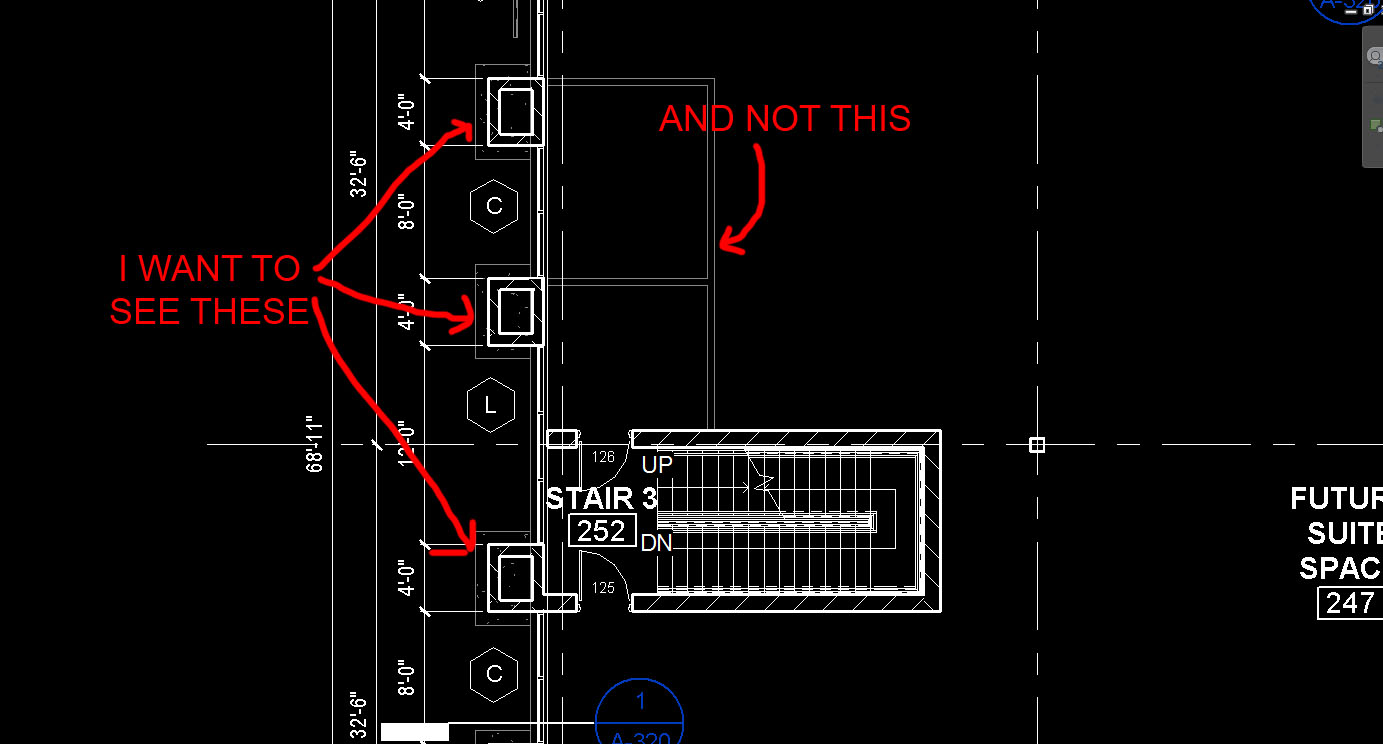

I am doing a building in 2015 that has peirs with cornices 1' below every level grid all around the perimeter of the building. I am using underlays in my floor plan views to show them, but then i have to go around and manually hide everything else in the underlay in every view. Is there a quicker way to hide objects showing through the floor while allowing objects on the outside of the building to stay visible? The attached image is the second floor plan

Don't use an underlay.... set your view depth.
