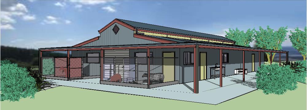

I have imported an image of the sky (jpg) into perspective view. When I try to print to PDF it strips the image of the sky. Iwas able to export the view as an image - it worked, but I need to place it on the sheet and print to PDF. is there any solution to it?
images attached - you can see one is a pdf image printed and lost the sky. Thanks in advance.

Re-import the image and place that on your sheet.

I have and I have tried  attaching different image - same result. I was able to export as an image to jpg though. it really puzzles me.

It sounds like your PDF writing driver may not process this correctly.  Try something else - we use cutepdf.
I did not mean to re-import the background.   I meant for you to import the finished image an place that on your sheet.
