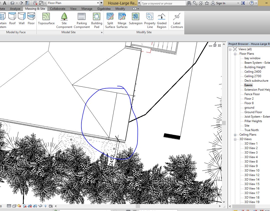

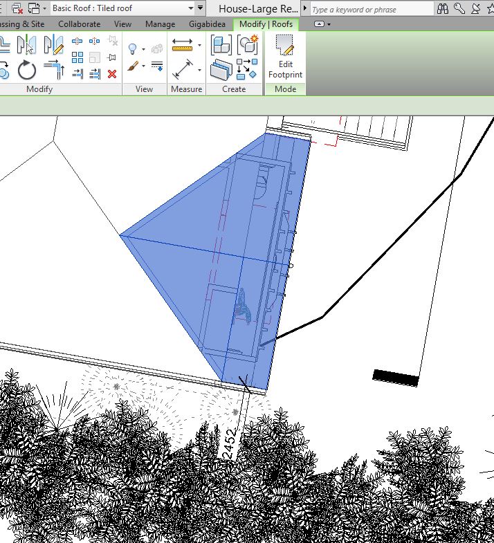

Hello,
Please see pics attached. I can't get the highlighted line to dissapear. I think it has something to do with the slope, however both the existing roof and new gable extension have a slope of 30 degrees. I also tried reducing and inceasing the width of the new gable with no luck.
Cheers
Ana
Mon, Dec 1, 2014 at 8:04:02 AM | Annoying line in joined gable roof
If you joined the roofs and the line didn't go away then either the angles or the height is not the same.  Be careful - 30 degrees may not be the same as 30.001 .... If it is fixed at 30 on both then you should be ok.  Cut a section and LOOK!
