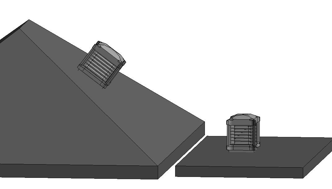

Hi,
Can you tell me, I want to place an object on pitched roof but the half part of the object is going inside of the roof, here what I want that the bottom part of the object should be 200 mm above of any kind of the pitched roof. (see the image windcatcher-1).
The object is going good with flat roof.
Tue, Jan 6, 2015 at 8:47:13 AM | Place a Vertical chimney on pitched roof with opening
You need to edit the family and either adjust the geometry so that it works or add parametric controls so that you can adjust it in the project.

Ok, let me try.
