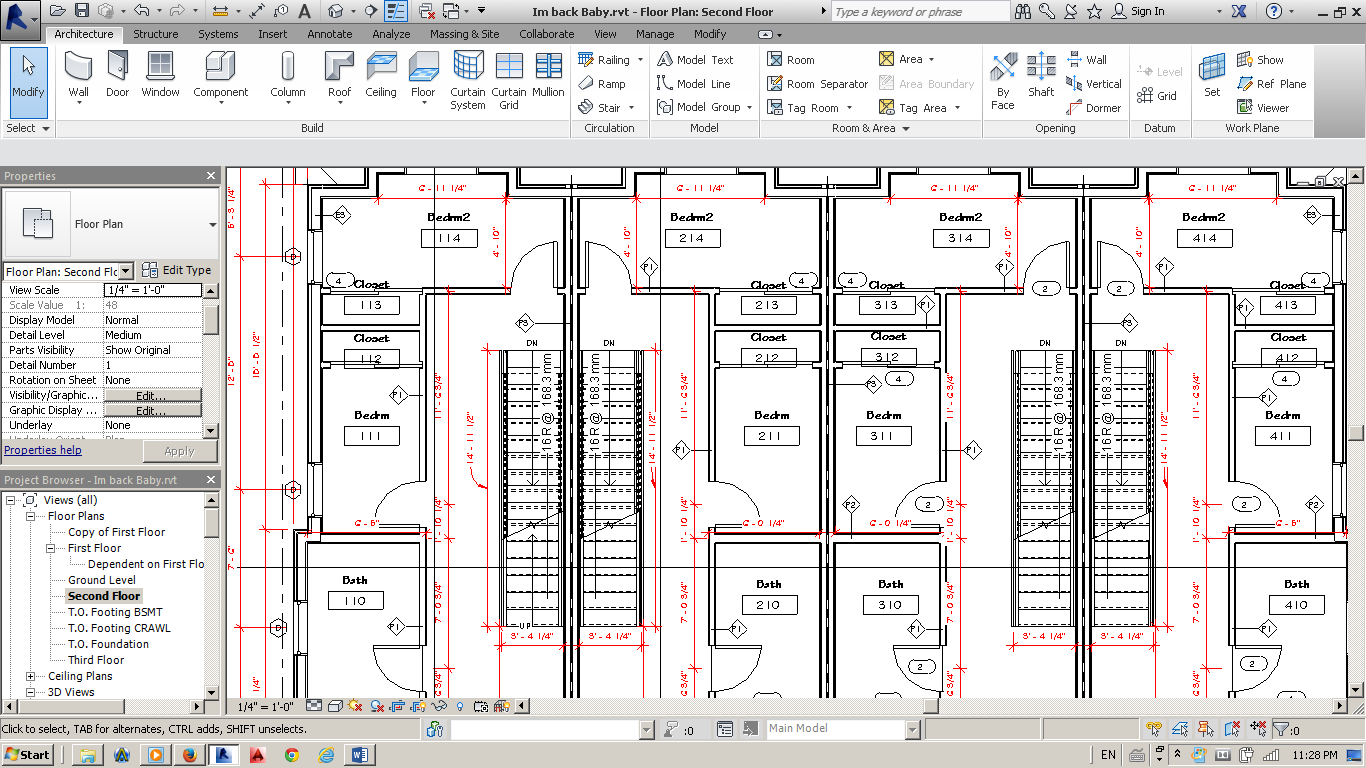

I made an opening on a floor for my stairs in a 3 floor home, however for some odd reason, In plan view, I cant see the stairs through this opening, just a white empty hole. Theres also a number of wierd instances:
  1. On the other floors, I am still able to see the stairs showing through the openings in plan view.
  2. For some reason I cant delete the opening, its as if its part of the floor, I have to undo my opening inorder to do it again.
  3. I cant edit openings anymore to edit them, nor can i click them, when I try clicking it, it only selects the floor.
Can somebody help me, i really dont get whats going on???
Thanks

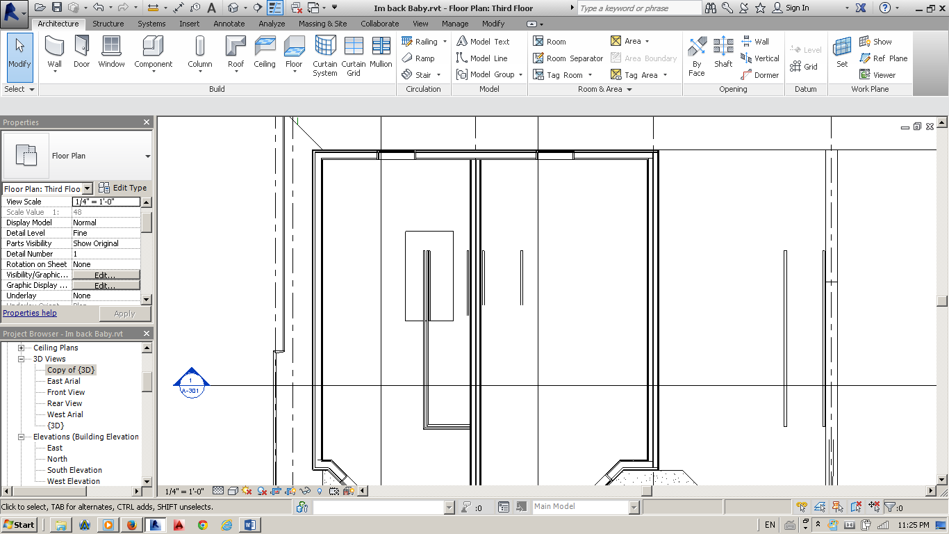

My view range properties for the 3rd floor where im trying to make a vertical opening for floor to floor stairs are the following:
  • top: 7'-6
  • cut plane: 4'-0
  • Bottom: Associated level 3rd floor - no offset
  • Level: Associated level 3rd floor - no offset
Heres some more additional info that could be of use:
  • The height of of my second floor to third floor= 8'-10
  • The height of my third floor to roof=9'-10"
Hope this helps!
I even tried editing my floor but I still cant even see the stairs in plan view.
Thanks

Why is it that when I create a shaft on the floor (which isnt pinned) I cant edit it??? I used to be able to and now I cant. My stairs are solved, I went to Visibility/Graphics overrides and checked stairs.
Wed, Nov 26, 2014 at 10:35:34 AM | Cant see stairs in opening in plan view
Shaft openings have their own category in VG.   Are they on?
