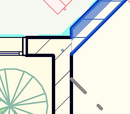

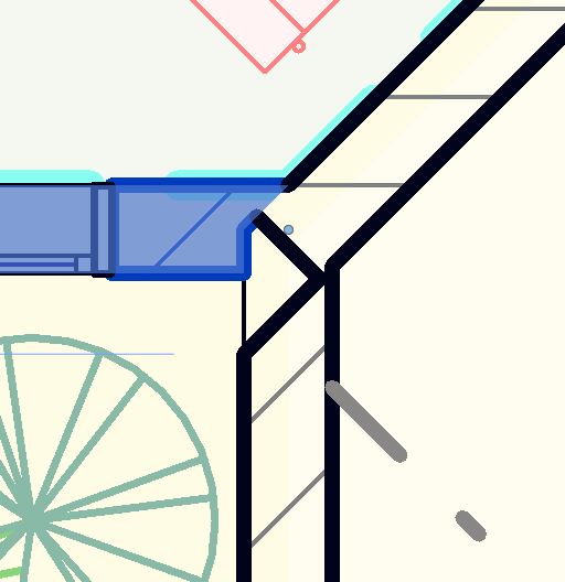

Just wondering has anyone else noticed that their 3D walls aren't joining properly in Revit 2015 ?
We are having issues where walls aren't joining at corners, intersections, etc properly and we have never encountered this problem with any previous versions of Revit. (refer to attached screenshots)
I know that it can't be to do with any of the wall properties as we have carried over our standard Revit template file which we used in Revit 14, 13, 12, 11 ... etc beforehand and we have never had this issue.
We haven't changed how we insert 3D walls into the project either.
Are there new settings in Revit 2015 which is causing this problem ?
I am absolutely baffled and can't work out any reason why this is happening.
Any advice or ideas would be greatly appreciated.
Thanks in advance.

We have installed the latest Revit 2015 update and still having this same issue.
We thought the same thing about the wall heights and levels they are attached to so I played around with assigning the walls to different heights and making them all the same height and nothing changed.
I just tried using the wall joining tool like you suggested, same thing nothing changed.
The only way I've figured out how to get around this is by "disallowing" a join of one of the walls and then dragging it out to line up with the outer face of the other wall, and then manually using the join geometry tool so they join properly in plan.
Unless there is maybe another Revit update I'm not aware of that would resolve this issue ?
Thanks for your help so far
Ps. I have just checked and there is a Revit 2015 update 4 which is out for download, we had only installed update 3.
I am just downloading this now and hopefully this might fix the glitch.  I'll keep you updated

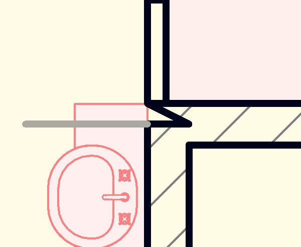

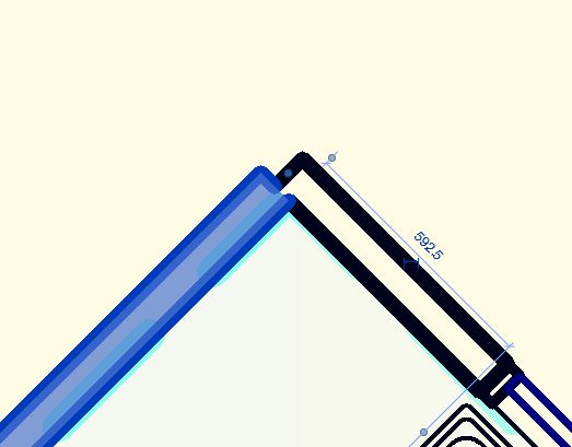

In a bad case of irony, since I'd let you know that the walls were joining properly after the installation of the Revit update 4, they have now started to not join properly again.
Still no ideas ?
UPDATE: Refer to attached image. This is starting to get really frustrating now, I have never seen revit behave in this way before.

There is other things going on here that we don't know about - probably some other wall causing this issue.
We have a user here that had a wall based towell bar that they wanted on the end of their vanity.  So they hid a very thin wall in the vanity group to host that bar.   This caused a whole lot of issues.  Poor choices lead to problems that are hard to find.

I had simmilar situation.
The wall join was obstructed by room separation line that was hidden in a view... however it was interacting in some weird way with wall joins causing them to join just teh core of teh wall but not insulation layers.
My advice : check if you don't have room separation line buggering about the join - I lost my lunch money over it
