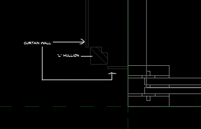

I always have problems with getting corner joins on curtain walls..
I have a box curtain wall..I found a "L" mullion and I turned the curtain walls in a regular wall joined them at the corner and then turned it back into a curtain wall..
The "L" mullion when I put it to the two corners didnt exactly join and there is a space between the mullion and the curtain wall.
help.

not sure I understand but yo do need just 1 mullion at the corner, not 2...
if that does not answer your Q post and image.

This is what I mean..See the space..

I C...
this is because your curtain system panel is offset.
in the project browser, go down to families--> curtain panels-->system panel--> glazed right click and go properties, change your offset setting...
HTH

hey I tried that and still ..Im getting a space
can I send the file to you..

Hey after some messing around I got it .. I actually went into the mullion family and messed with the offset and size..
Ty for your help.
