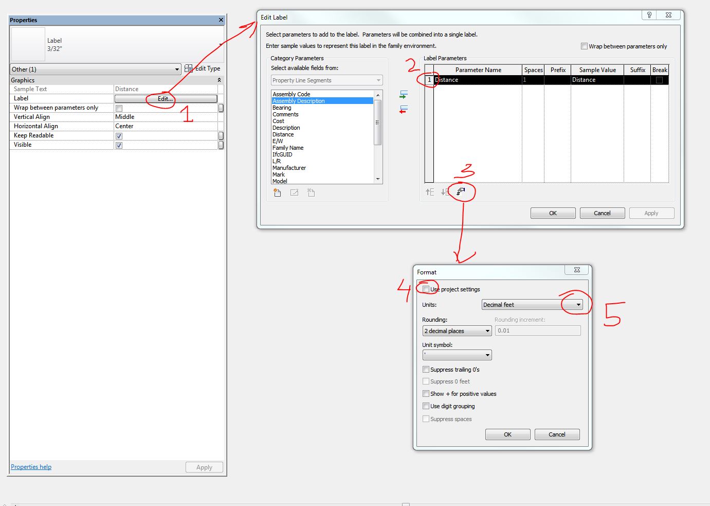

I am in the process of creating tags for use with the graphical column schedule.
I have added a base plate to my column familys, with shared parameters. The parameters ask for dimensions to define the base plate.
The column tag I am creating pulls the base plate dimensions.... the only issue I am having with this is the base plate dimensions reporting in feet and inches. Is there any way I could change them to report only in inches? ex... 1'4" = 16"
I attached some screenshots to clarify. let me know if I need to post more information.
I have only been working with revit for a few months so let me know if my terminology is off...
Any help is appreciated.

If I understand your question correctly, in the tag family, select your dimension label and follow the picture.

I feel like a bum now....it was that easy.
Thank you!
