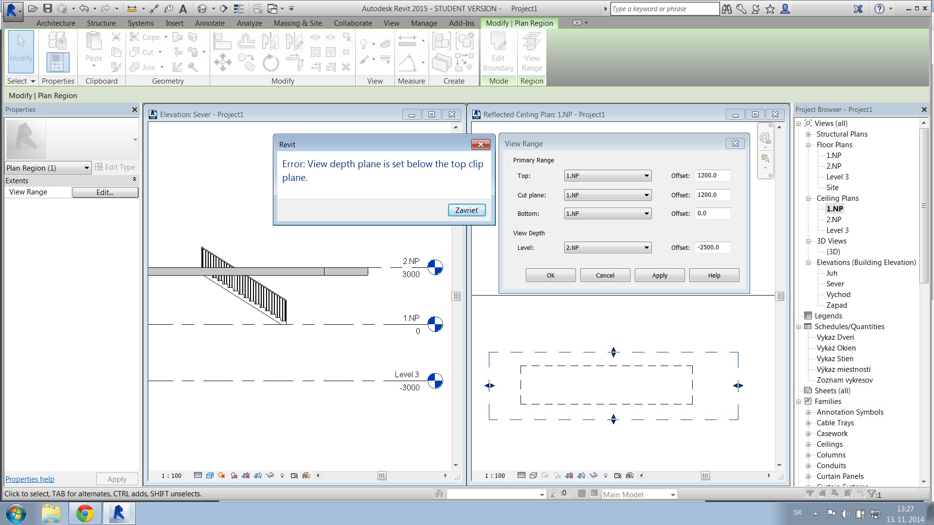

I try solve my problem by plan region, but when I want set deeph of Level under the Top - make error. I can set up View depht level under Top....Where I make a mistake?

A plan region will not solve your problem.
Read the error message and look at your settings.

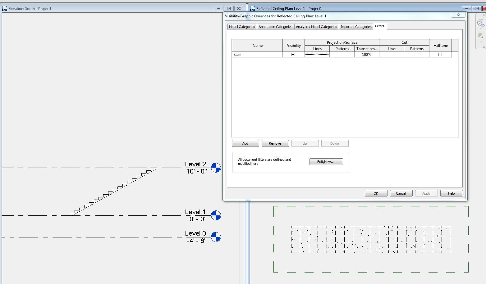

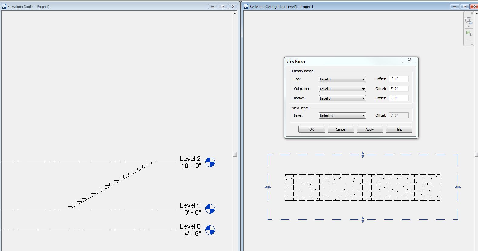

The view range should be set to the level below the bottom of the stair with the primary range also below the bottom of the stair (except view depth) – pic 1.
Set up a filter to get dashed lines if desired – pic 2.
