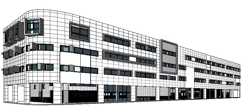

hi... Does Anyone know how i can align a pattern in a curved wall??? I am having trouble with that. The "align" command does not work in a curved wall... Any suggestion???? Already checked everywere...but no help on this issue... Can you please help me??? Its kind of urgent!!! Thank you!!! Post edited on 2006-03-12 20:52:50

are you putting your mouse over and "tabbing"?

well, i tryed everything but i cant do anything... it just doesnt select anything....i needed to print in the shaded view but so the pattern would be visible I ll try to upload a view

No problems achieving what you're after here... NOTE: The align tool will not work to align the patterns. In elevation, tab select a pattern line then drag and align it "by eye". As Eldad eluded. HTH.

Eureka ! you can move the vertical lines of a pattern, on a curved wall, by rotating it in plan view using the center of the wall (of course)
