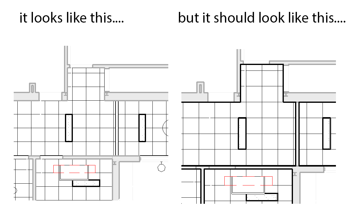

I have existing space with a new ceiling.  The existing walls are shaded.  I cant see the projection lines of my ceiling through the cut lineses of the wall as they occupy the same space.  is there a way to override this? so my ceilings edges take precedence over the wall cut lines - even though they are beyond the cut plane?
thanks

I suggest you change the setting for the projection lineweight of the ceiling.
Remember, you can / should use view templates.  In a RCP, we always back off the wall / cut lines ikn our template.
