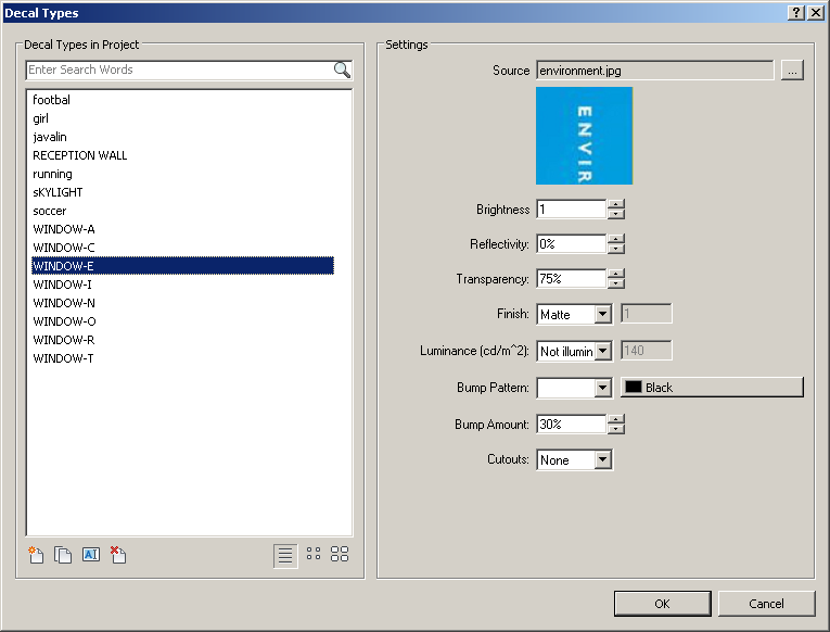

I have placed decals in windows for an interior rendering.
I can't see them in the view when it's set to "Realistic" and I can't see them when they're rendered..
Any idaes??
Revit 2015

Also, I have several decals created with different images. When I render the images are all the same?

Tue, Nov 4, 2014 at 10:42:53 AM | Decals not showing..
READ AGAIN - You have obviously not defined your decal types correctly - they are all pointing to the same image.

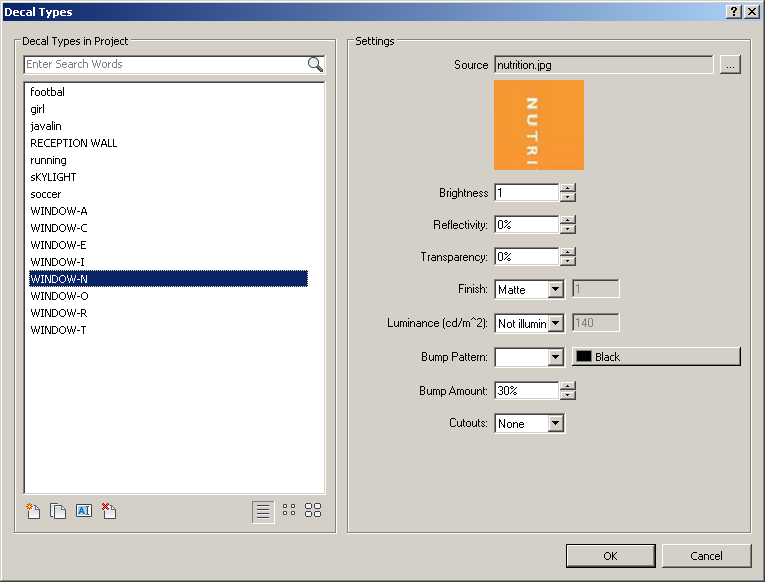

They preview with different images, they all have unique names
Tue, Nov 4, 2014 at 11:59:03 AM | Decals not showing..

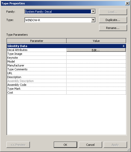

First, make sure you don't have multiple images in the same place.  Then
  • Show us a snapshot of your detail types showing the source image for each.
  • Show us the properties clip for each of the two image types

I had to find a work around so I did it with materials but using decals would have worked a lot better...
I was hoping this was a known problems....
135432_Decal_Type_1.png135432_Decal_Types_2.png135432_Properties_C.png135432_Properties_R.png
Tue, Nov 4, 2014 at 1:33:26 PM | Decals not showing..
#9
I have no problems with decals in 2015.  Multiple images in multiple places.
What you show us appears to be correct but without see the model, we can't really tell.   I think this is still a user error problem.  Image must be on the correct face is a normal problem - especially if the host face is very thin.
You orginally said you can't see in realistic or rendered, then you say it renders all with the same image.   Which is it?
Run a test - place each of these two images on the same face of the same wall and render that.  Maybe that will help you find the problem.
