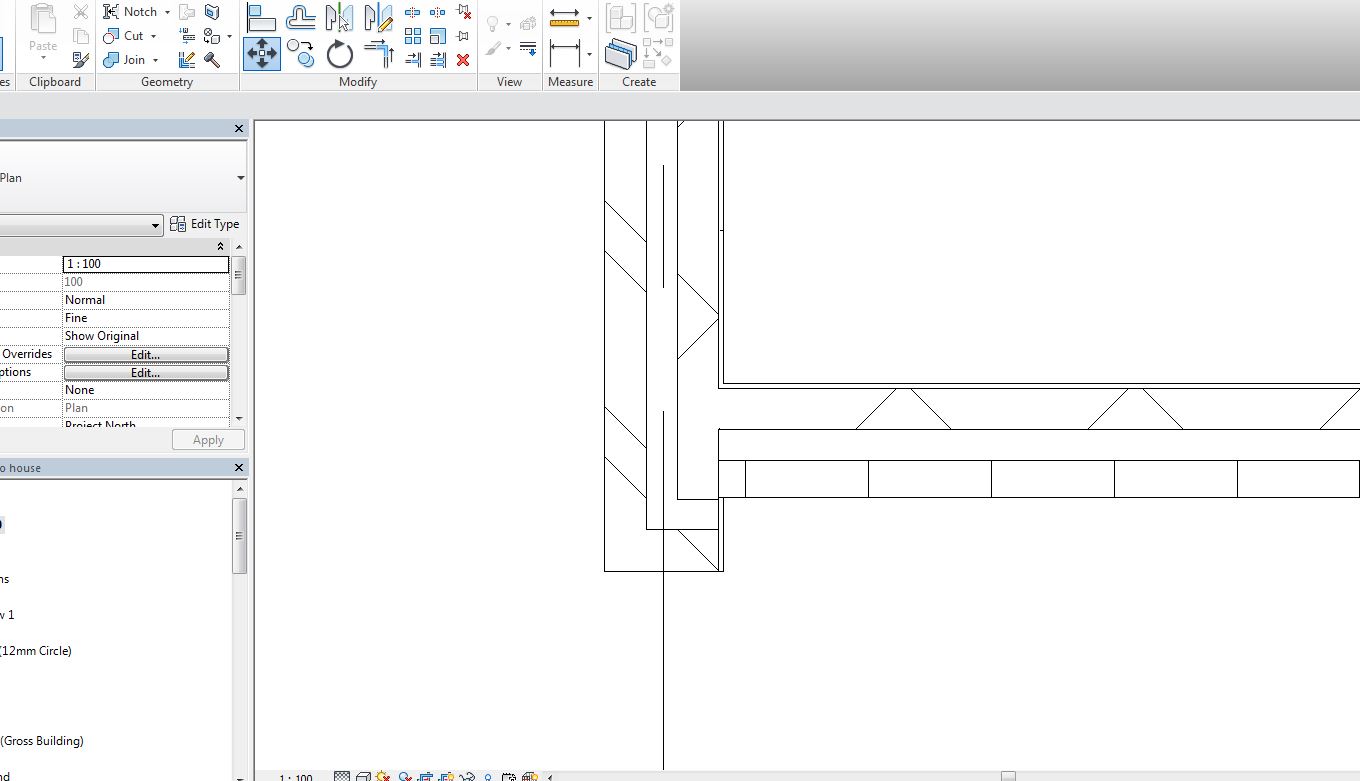

I m new to Revit and I m just modelling a house and try to make things work as they should be !
Now I came to a thing that I cannot solve either through a tutorial or any book or so.
I got a wall with brick, as external wall and another external wall with render. The render wall is
joining into the brick in a 90 degree. First problem is: How can the brick wrap around the insulation
completely ? I know there is wrap in the type setting but is just wraps partly. Second problem.
The external wall has a an internal side that is finished with render and another that isn t as its only outside.
How do I get rid of the wall finish on the front bit ? Hopefully anyone can help me, its really appreciated.

The end wall - your problem is that inside layer.... you will have to use a short wall here that does not have that layer.  Then the outside wrap will work.

Thanks a lot WWHub !
It now worked and the chapter in the Help is what I needed.
