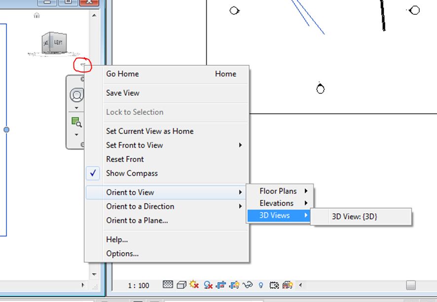

hi Kenyhel,
Have you tried orientating to view?
On the camera view, beneath the cube, click the arrow and select "Orient to View" then "3D Views" and select the view you want the camera to orient to. See attached.
Hopefully that was what you were after.
