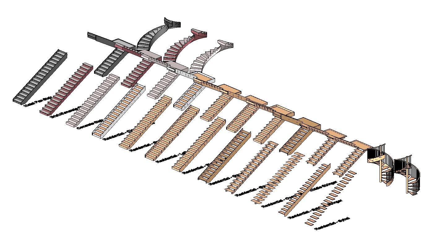

Hello! I'm trying to figure out how to implement two different kinds of floating staircases into a house. One is a straight floating staircase against the wall and the other is a free-standing spiral floating staircase. The two images below represent what I'm trying to put into my designs. Thanks so much!
Tue, Oct 28, 2014 at 1:22:55 PM | Floating Staircases
The attached image shows all of the stairs you can create ujsing Revit's standard stairs.  Yours are there - you just have to study the process.  Try watching some videos and reading about stairs in your help.

My issue is there isn't a pole in the middle of the spiral staircase. It's supported by wood underneath it, which is not one of the loadouts.
Thu, Oct 30, 2014 at 1:50:26 PM | Floating Staircases
There is no such item in spiral staircase definition.  You have to add one seperately.  Use a round column.

 How would I get rid of the column though?
Fri, Oct 31, 2014 at 1:09:22 PM | Floating Staircases
Your question sounded like you wanted a column so I answered you that way.   If you had looked at the image of stairs I posted, you would have seen that there was a straight one with only a center support.  This can be defined in your stair types.   The stairs I posted are all on line in the old Revit library.   So I edited that file to just use that stair definition in one of the circular stairs.   Here it is.
