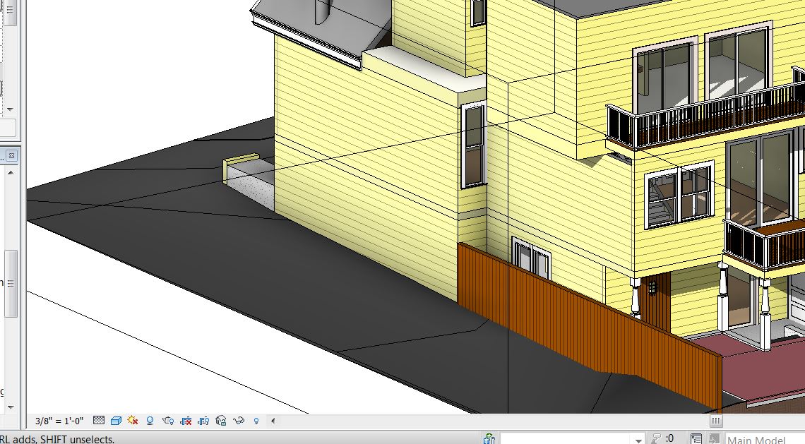

So some 3D views have this nice subtle shading.
I can make my other 3d views match it by making a view template of the one I want and apply it to the ones that need it. but I would like to know where that setting is. I simply can't find it.
here is a visual example
Thu, Oct 23, 2014 at 3:58:22 PM | 3D Views with subtle shading
That "shading" is automatic.  Material color changes automatically with the angle from your view ....and light if you have it on.
Thu, Oct 23, 2014 at 4:39:33 PM | 3D Views with subtle shading
Warchitect
Joined: Wed, Aug 20, 2008
318 Posts
4 Stars: 5 Votes
Sorry. its not the color shading on the surface. its that subtle darkening around the edges etc. if I make a 3d view its normal shading, but I have some that have that extra tonal effect across the surface, almost like an airbrushing tint at the edges...
Edit: found it. under the shading options, its the "ambient shading" check box is on.
