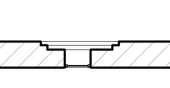

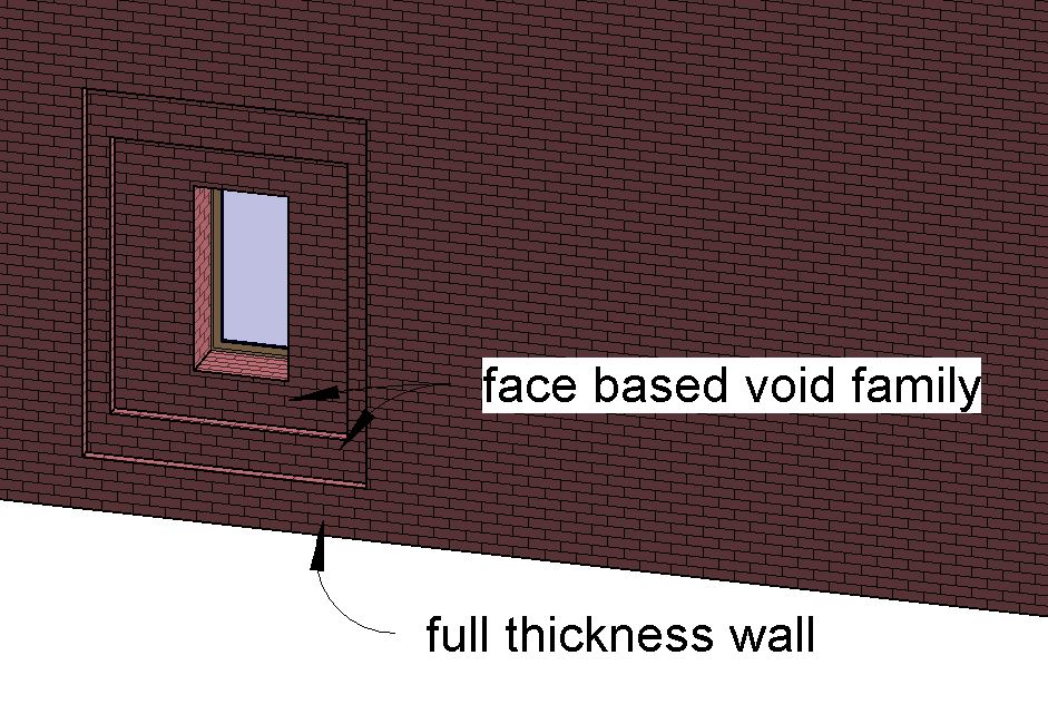

Tue, Oct 21, 2014 at 7:57:15 AM | Beginning problem for a beginner
DON'T USE MASS!!!  This is a good tool for sloping walls, really odd forms and quick planning but it is always preferrable to use regular revit components whenever you can.
See attached:
  1. Full thickness wall
  2. Create a face based, parametric void family to cut your wall step backs
  3. You will have to paint the step back faces
  4. Create an appropriate window family that has an adjustable exterior/jamb trim
Basic problem
