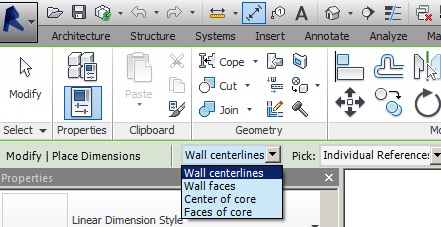

I did read your first post but the "feel" just isn't a revit process.
Do you know about this setting?

Yes i know those options. They don't help me with our problem.I don't know an other way to explain than i already did. But i can try once again.
When dimensioning walls from a linked file only one refference lights up. It often is just the wall centerline, but somtimes it's the wall end or just one face. It seems random.
When using tab, Revit 2014 showed me witch refference i'm going to select (face 1, center or face 2) by showing it in pre-selection color. This way you know for sure your dimensioning the refference of your choise.
At this moment revit is not showing me what i'm dimensioning. I hover over the wall, the centerline is highlighted, i use tab one time and then i than i hope revit uses the wall face to create the dimension line. I don't like that. Especialy when creating a long dimension string its very annoying not knowing for sure if the face is selected before left-clicking.
