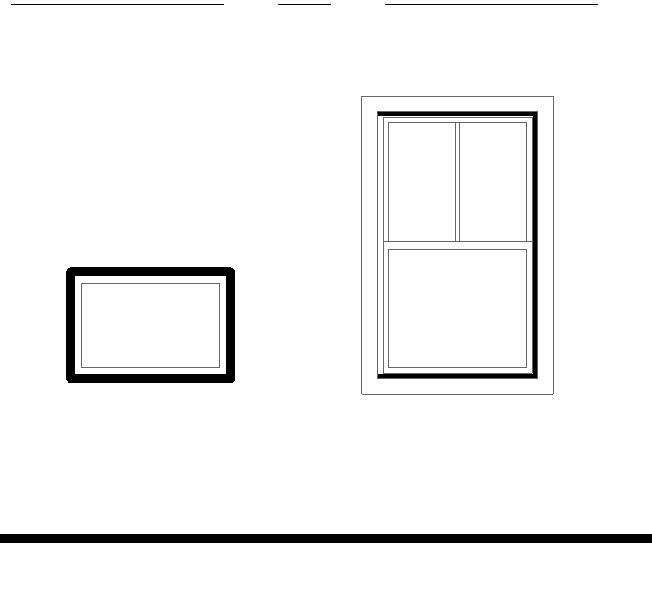

The problem is how your window family is built.  If any part of the opening is visible, then your projection line setting for walls will apply to that line.

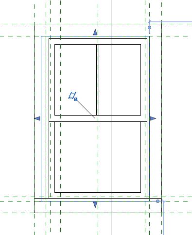

I heavied up my wall projection lines.  The window on the left has no trim so we see the edges of the wall at the opening.  The window on the right has trim over the wall but the opening cut (a void) was at the same location as the trim edge so the opening still showed.  I modified the void cut on the left side dragging it behind the trim to what might be a rough opening and the heavy line is gone here.  The window family elevation is shown on the right and you can see that I dragged the left side to behind the trim.
