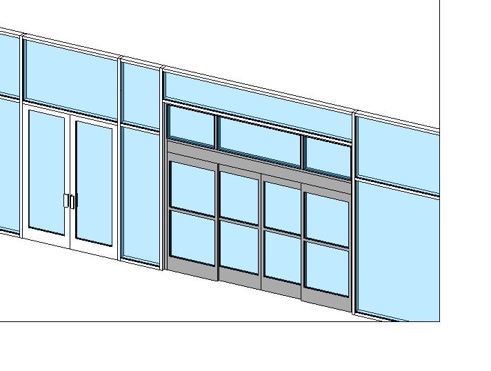

You do not have to use a curtain panel door, you can use a wall hosted door like the ones shown on Autodesk seek..
  1. Make sure the CW framing is spaced correctly for your door
  2. Swap out the panel for a generic wall
  3. Place your wall hosted door in your wall and adjust its location.
  4. If you have to, readjust your grids
The attached automatic slider is "in" a curtain wall.
