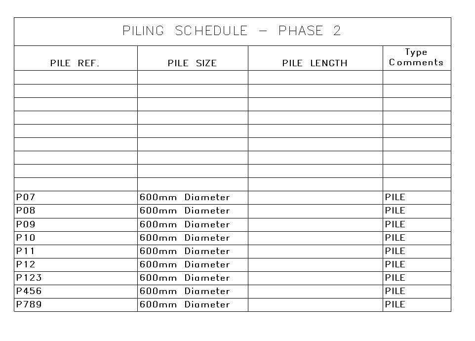

Hi,I'm working on a project where I've got the Model file linked into the Sheets file. In the model file, I have pilecaps and piles, which I need to schedule separately. In the Model file, I can schedule everything fine, but when I repeat the same schedule in the Sheets file, it seems that each scheduled foundation element has another blank line associated with it. If I remove one pile, then one of the blank lines disappears too. I've tried filtering out by Mark or Comments but it doesn't work.There's nothing wrong with my pile or pilecap families, or else the Model file would get the same issue.Anyone got any ideas about this? (Image attached for clarity - I hope!)

It's fairly standard practice to have several models linked into one master file, which contains all the drawing sheets. This has been widely done since Revit 2009, when the ability to tag linked models was added. That's not the issue here, though, I was just pointing out that in the model file the scheduling worked OK which proves that it's not a problem with the pile family...

Problem solved - while checking for solutions I saw that there have been several updates so I downloaded and installed the Update Release 4 (4 already?!?) from the Autodesk website and this seems to have fixed the issue.
