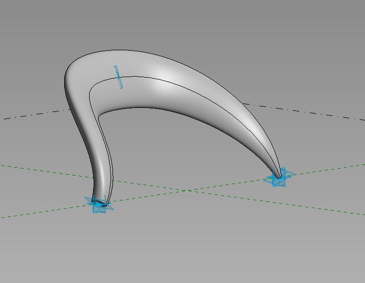

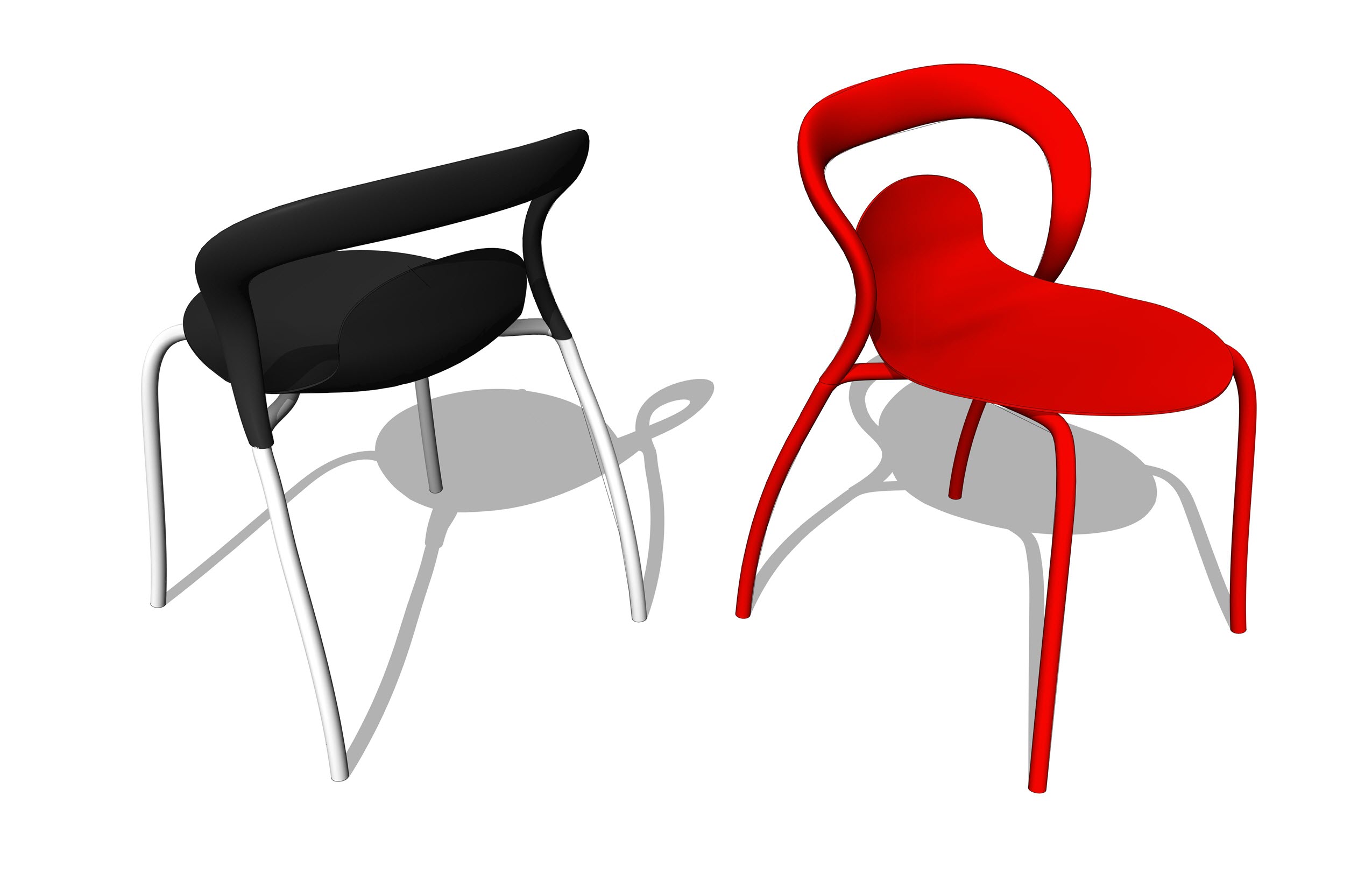

Alright, I feel like I'm missing a major step here so hopefully someone can help me out.  You can see I am trying to make an undulating multi-profiled chair backrest. It has been modeled in CAD as the pic shows.
(As I trial run I did a much simpler version than the exact object.)

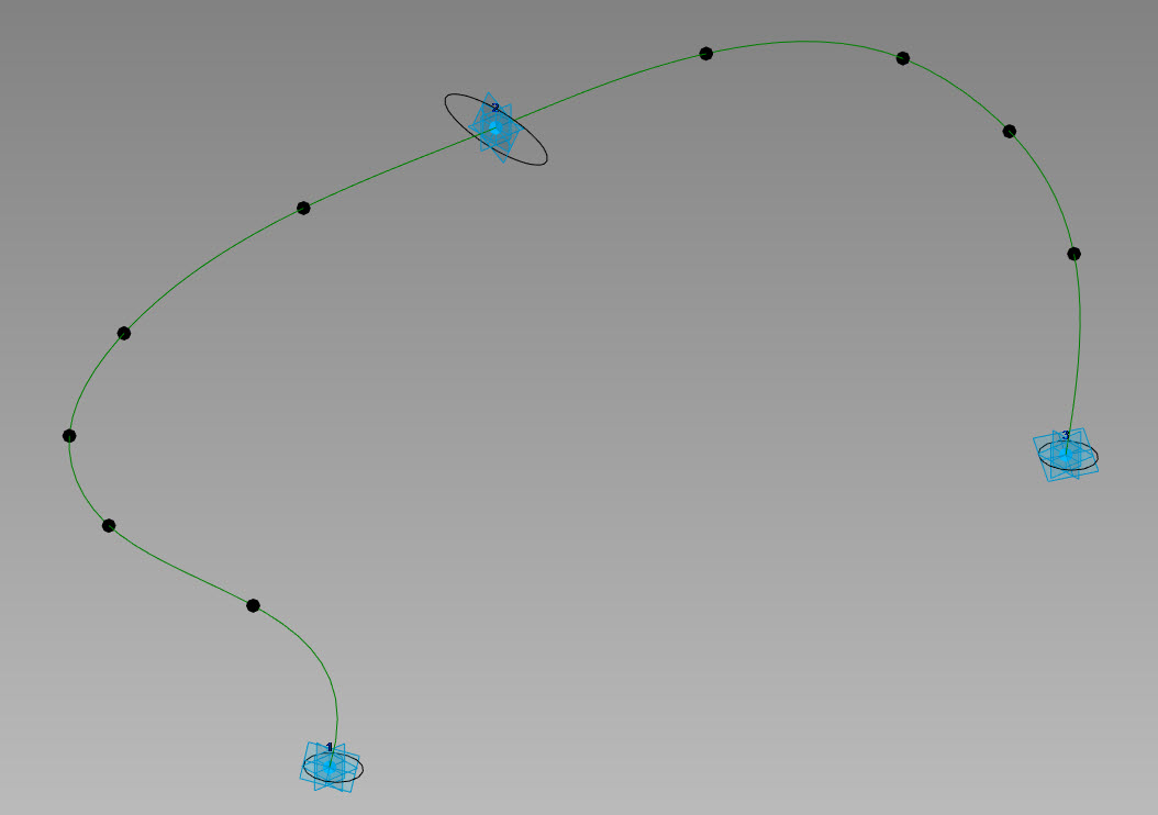

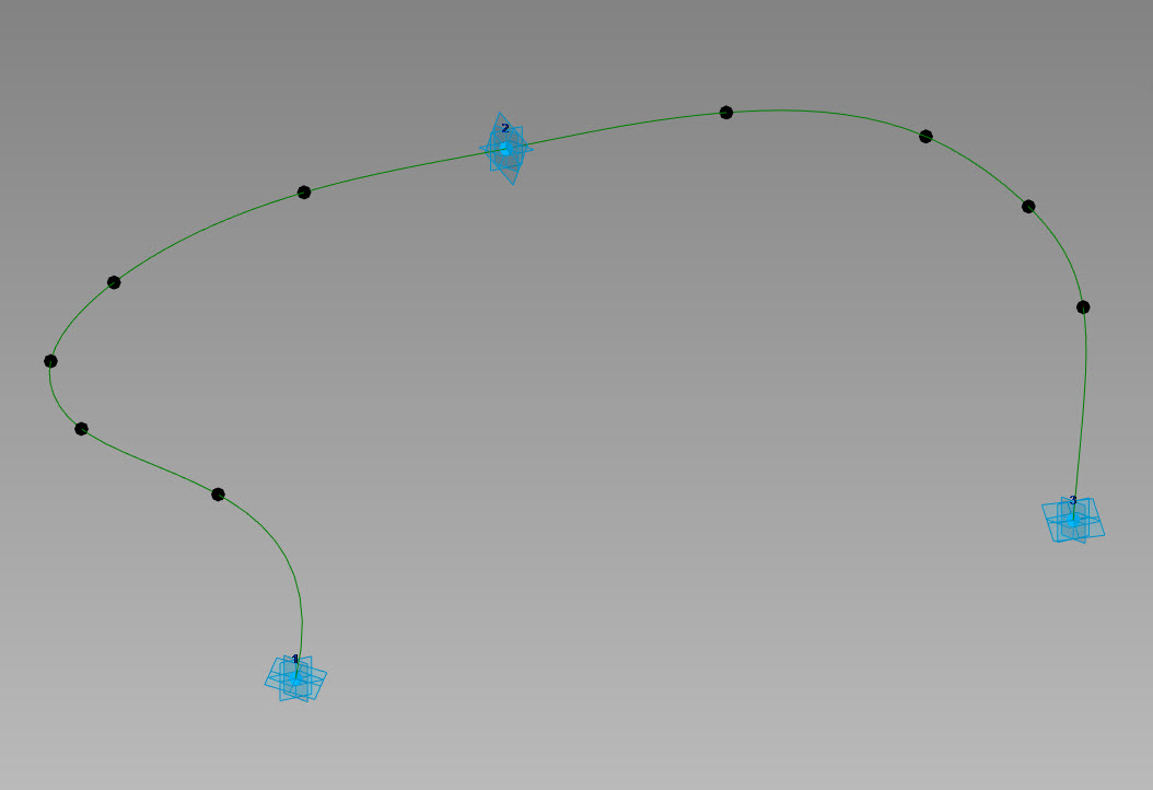

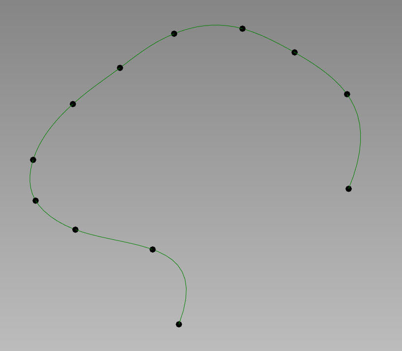

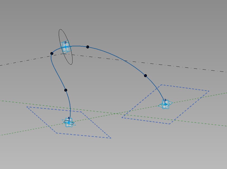

First, I made a Reference Line using the spline option.
Second I adjusted the height and location of each of the nodes to be similar to the CAD backrest.
Third I chose the first, middle, and last nodes to be "made adaptive" using the tool of the same name.
Fourth, I placed the desired profiles (which is also an adaptive family loaded in) at those nodes and selected "Create Form".

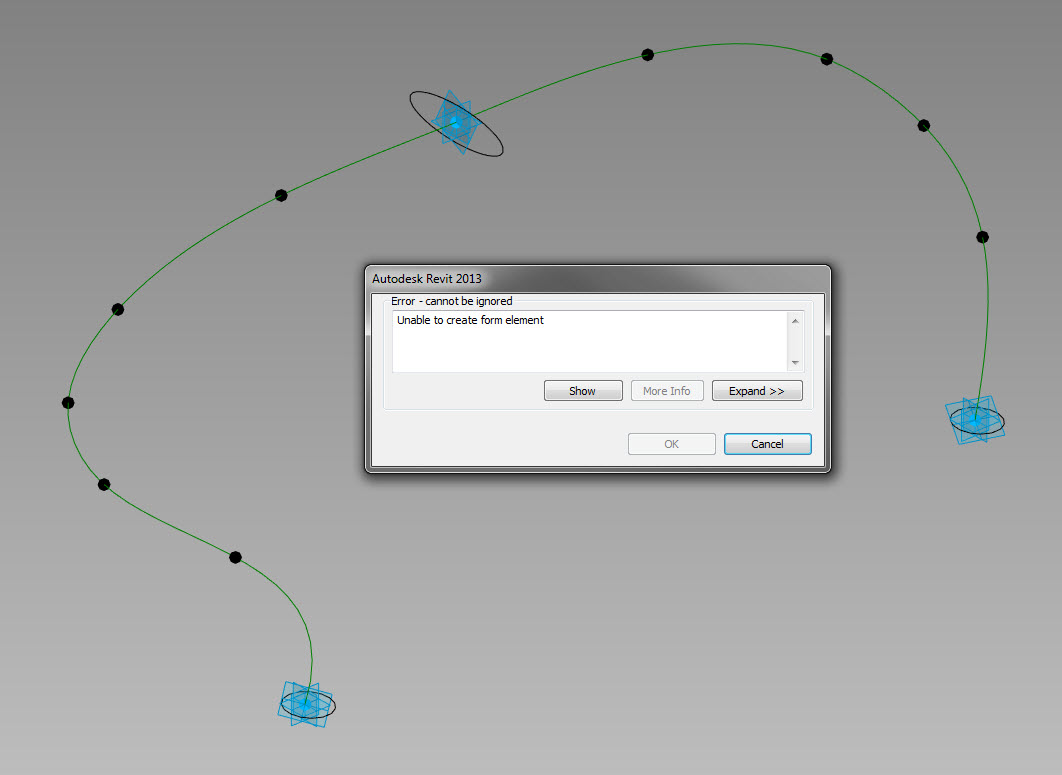

Fifth, I failed miserably.
I know I am screwing something up because just using simple paths and profiles isn't working either. So what am I doing wrong?

I think what happened was you didn’t put your profiles on the correct AP’s ref plane. The profile has to be perpendicular to the path. Ref point has 3 x,y,z ref planes and one that is perpendicular to the path. It is easy to pick the wrong one, but if you select your ref/adaptive point and check ‘Show Normal Reference Plane Only’ in the properties, the only correct (perpendicular to the path) plane will be visible – much easier that way. Hope it helps.
If still no luck, can you upload you file?

I did what you said and still got the same result. Thinking maybe it was my file, I tried this process using a brand new AC family. Same result...

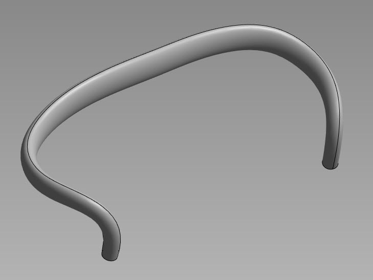

THEN, I tried drawing the profiles rather than using AC families as the profiles (as I had seen in a different link). That was the difference!
Worked like a charm once I oriented those profiles to the axis like you said. Thanks so much!

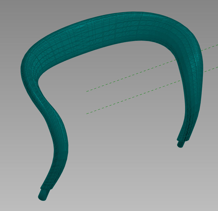

Thanks again for the help! Here's the final product... came out pretty good!
Here's the actual product: http://www.falconproducts.com/product/10485/CURV-Chair.html
