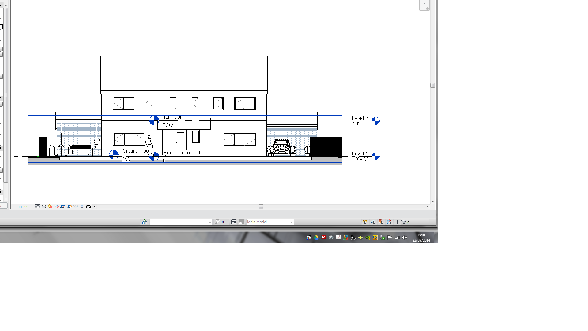

Hi, I just need help with hatches, i got my elevations but i cant see the roof slate in elevations, could anybody help me how do i get details/hatching of roofing slates and my rending on wall?, i have added my project elevation and example image how i want it , please help

Your images are two different buildings.  What is it you want? - communicate!
In order for material hatches to show, THEY MUST BE MODEL HATCHES and the category must be on in the view.

thanks for reply, the other building i just google it to reference/example...i re-attached my project elevation when you see it shows wall hatching but doesnt show roof hatching, my roof finishing material is slate, so it should show slates lines or something like it show bricks...??

Please learn to use your HELP:
http://help.autodesk.com/view/RVT/2015/ENU/?guid=GUID-8E88F590-4864-4C60-9433-4A70AC066605
"Materials define the following:
  • Graphics characteristics that control how the material looks in a non-rendered such, such as:
    • The color that displays in a shaded project view.
    • The color and pattern that display on the surface of an element.
    • The color and fill pattern that display when the element is cut."

Sorted! Thanks mate
