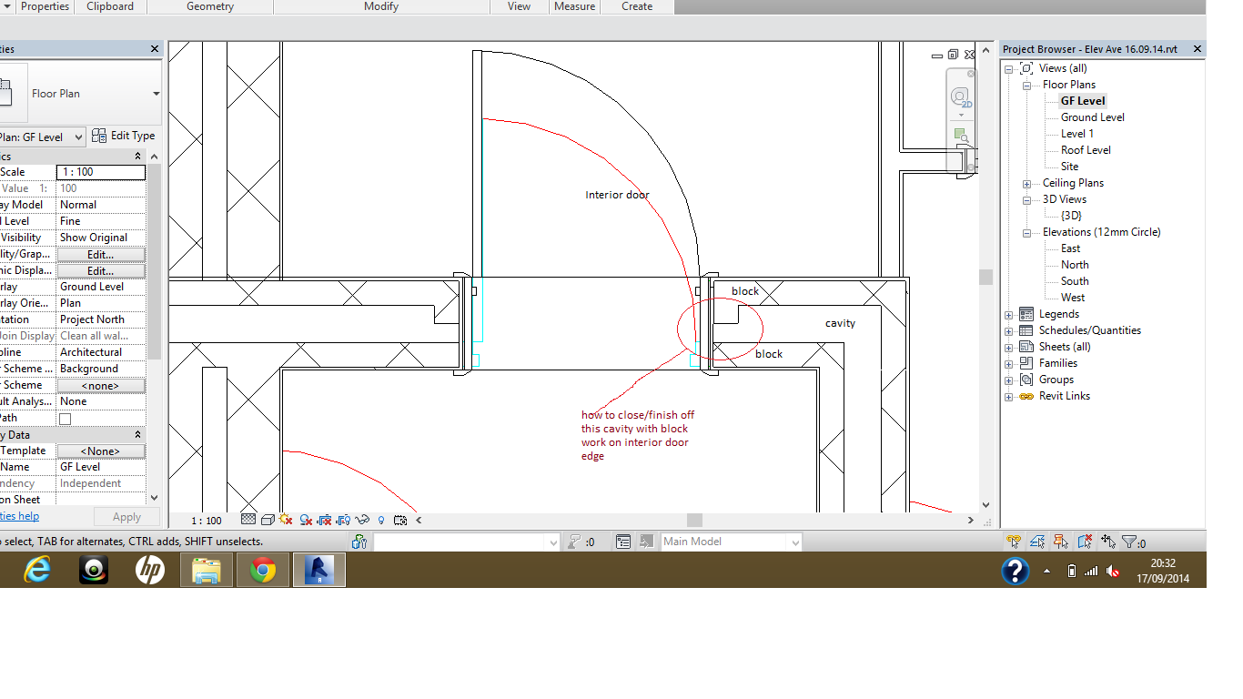

i am just wondering how to close cavity on edges when you place the door onto wall, i have attached photo for reference,
your help very appreciated
Ali

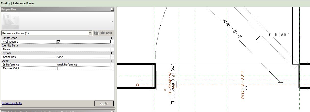

Only layers outside the core will wrap and you can set inside/outside or both.  Obviously here, you have one of the layers as finish.  You can edit the door family and add a reference plane set to closure to control the wrap point and a parameter to set where that point is.

it did worked out, thanks for help Smile
