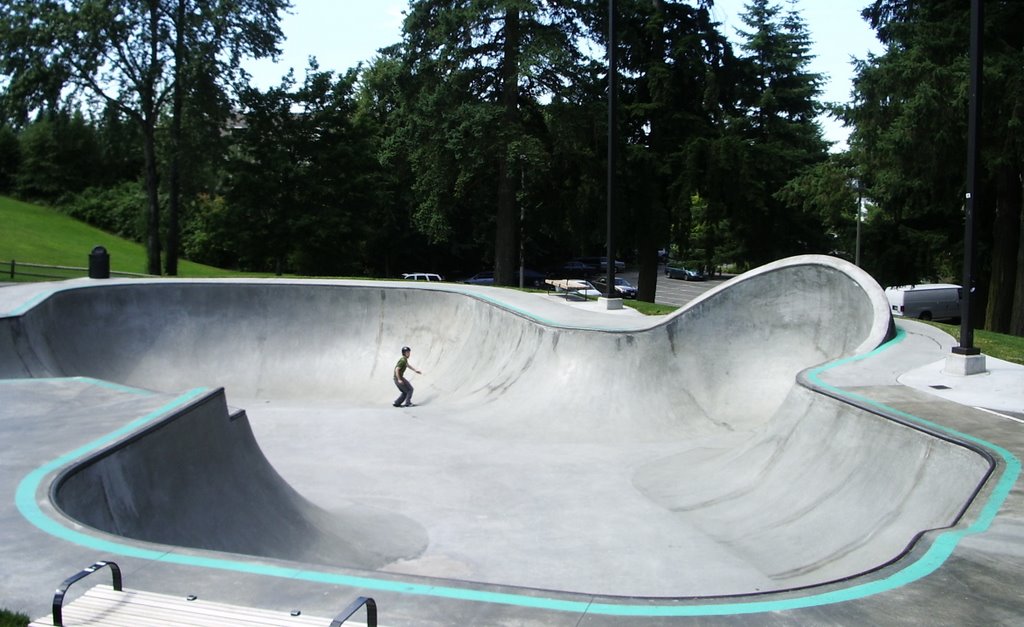

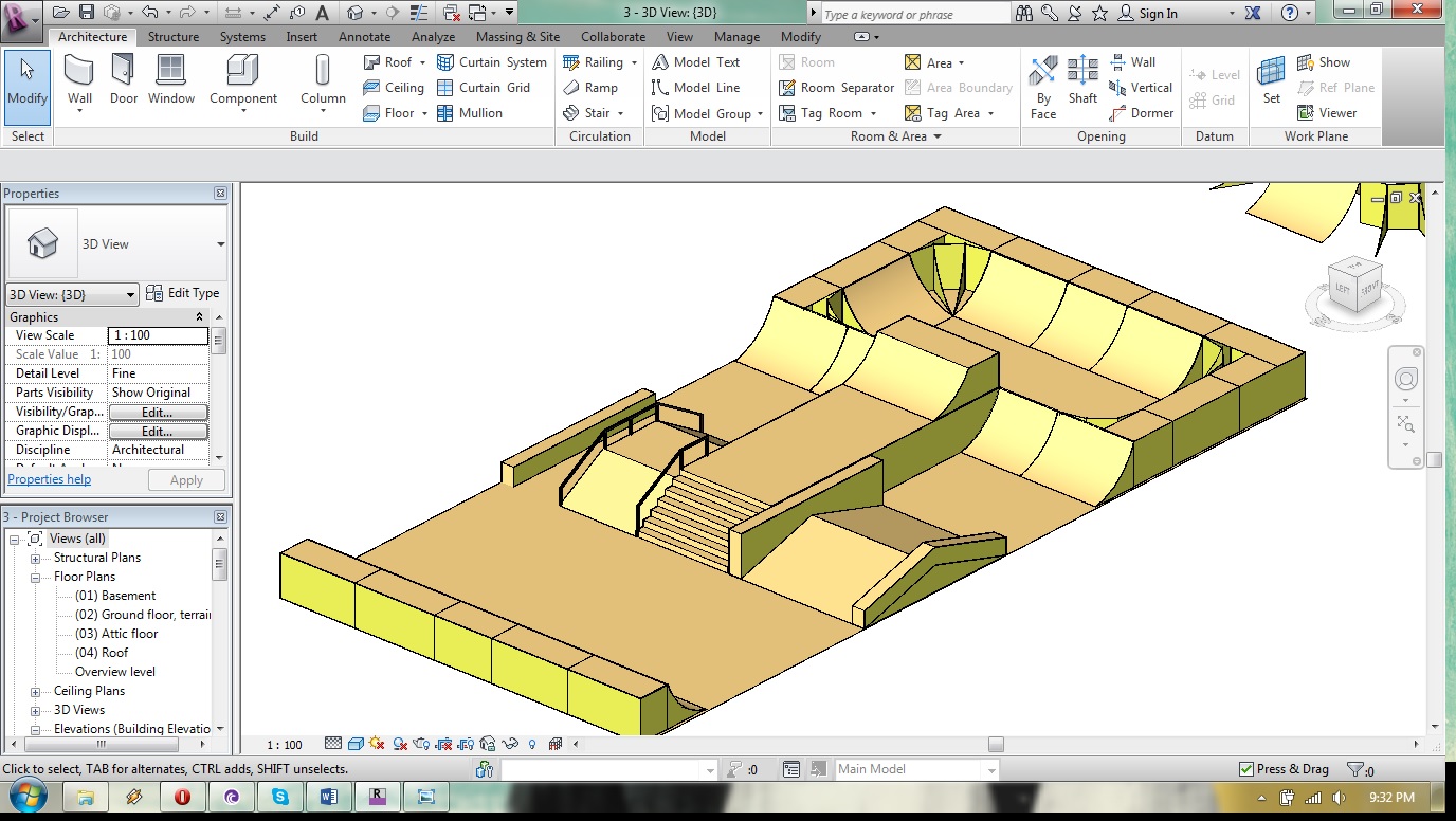

I'd like to create some skate bowls containing some shapes that are similar to the ones in the attached files.
The things that I don't know how to do yet are the bowl corners (out of one piece) and the spherical part.
Does anyone know how to design these things ? Please help.

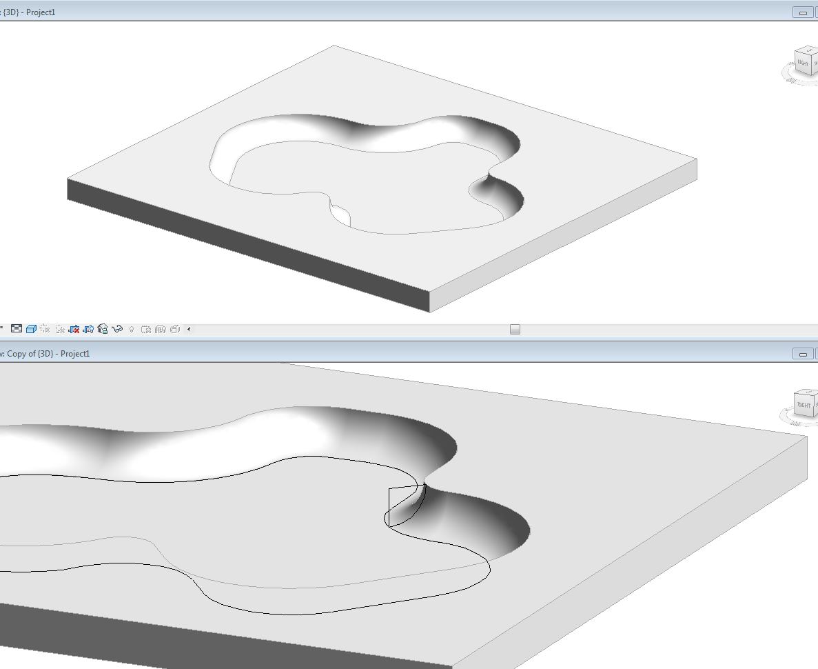

I'm using Revit 2014. I have attached a sketch with one of the parts that gives me problems here. (the uncovered corners)

One method could be a void sweep. With more complicated shapes, I’d look into a conceptual mass.

Also, instead of a void sweep and carving out the material, you could add the material with a solid sweep. Your choice.
