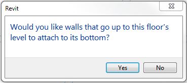

every time I draw a wall I undrestand that I can specify the wall goes from (for instanceSmile level 1 to level 2.
then, I have to manually sellect each walls to "Ataach Top/Base" to the upper floor. (that's a hassle !)
Consider at the beggining I dont know how thick is my floors , so I cannot use "Top Offset".
is there any way that all walls attch automatically to the upper floor/s?
Thanks

When you have your level 1 walls in place and when you model level 2 floor, you will get this message (see pic). If you modeled your level 2 floor before walls, you can enter floor edit sketch mode and without making any changes exit from there clicking on the green check mark – you’ll get the same message.
Be careful though, you might have some walls that you don’t want to connect, use it with caution.

Thank you so much
