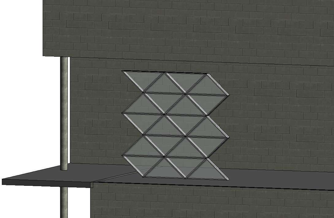

Im adding picture i hope you all understand my problem.
  1. i made mass and loaded custom curtain wall ( like it supposto do right? )
    1.1 How i get border mulloins?
   This is not releated to border mullions this is actually nice look
but still want to know how to get borders
  2. i loaded it into project but im not ebal to get this kind of wall opening
( cant seem to find nothing mass related auto emmed )
Revit what im using is 2015

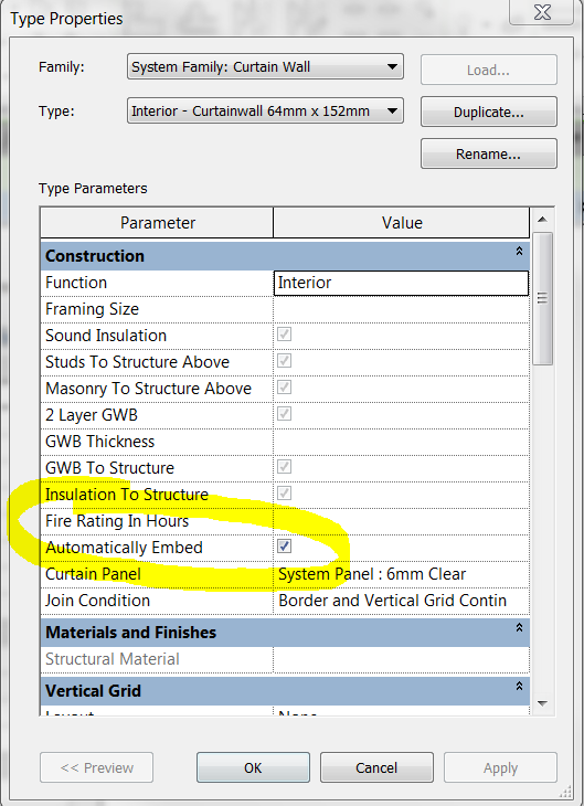

To start with you need to check the curtain wall type properties and make sure it says yes to Automatically Embed. See image.
Worst case scenerio you can edit the wall profile and use the curtain wall edges to sketch a hole in the wall around the curtain wall.
embed curtain not embeding
