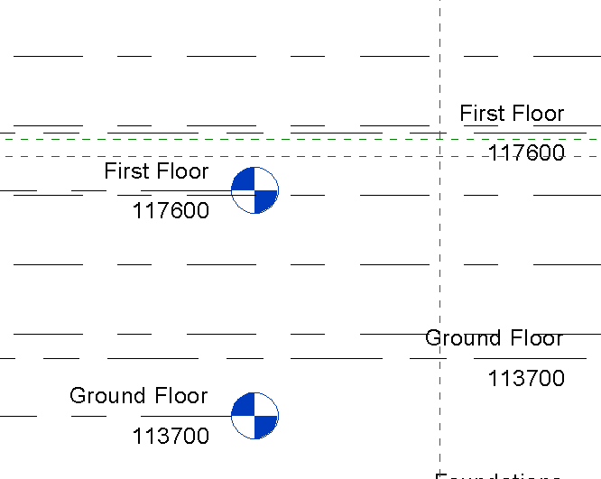

I wonder if anyone can help, i have been working on a structural model and linked in the architects model and this lined up fine.  Now the Architect has set a project base point, i have changed mine tot this and it lines up on plan but the levels are different by 1000mm, is there a way i can move my model down but keeping the levels and project basepoint the same.
Apologies if this is confusing and will clarify if anyone got any questions.

Watch this video to understand project and survey points and how to use them.
http://www.youtube.com/watch?v=BigvY4LT-RI
