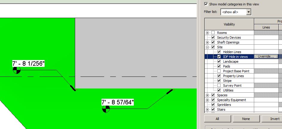

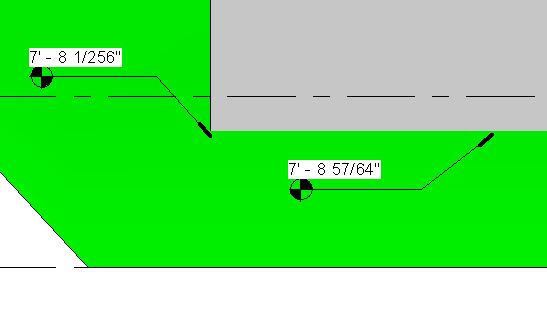

Thu, Sep 11, 2014 at 7:57:42 AM | Ground Line elevation markers
You can place a site hosted family that you can then tag the elevation.  It can be a model line in a new site sub-category that is normally off except when you need to see it to tag it.  You can just see the red line in the second image which is the IDF sub-category linetype.

Fri, Sep 12, 2014 at 9:34:08 AM | Ground Line elevation markers
Here is a quickie.... modify it as you need to.   NOTE - the red circle is a model line in a whole new sub-category that can be turned off in VG.
