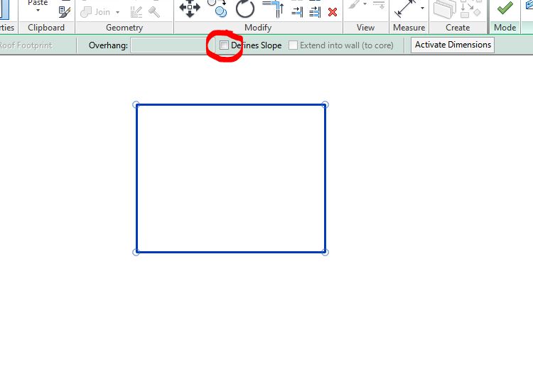

Hey I'm new to Revit and was wondering if anybody knows how to level the roof. This is only to build a dog house but it still bugs me to have an uneven roof.

Are you looking for a flat roof? While in the sketch mode, uncheck Defines Slope option.
