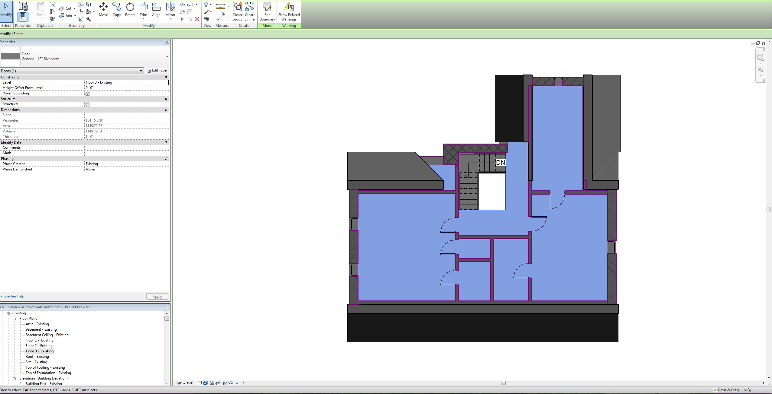

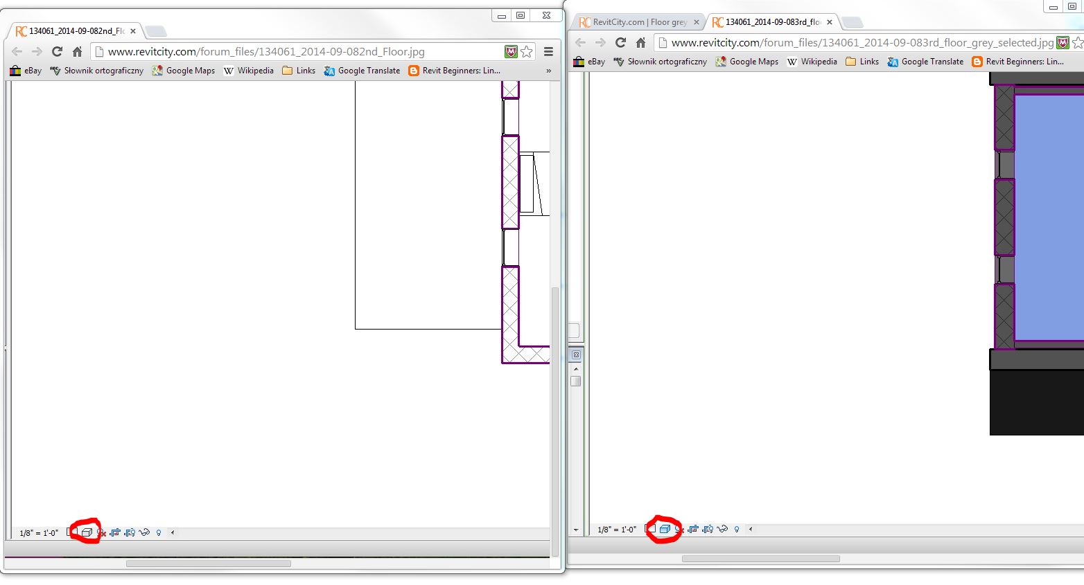

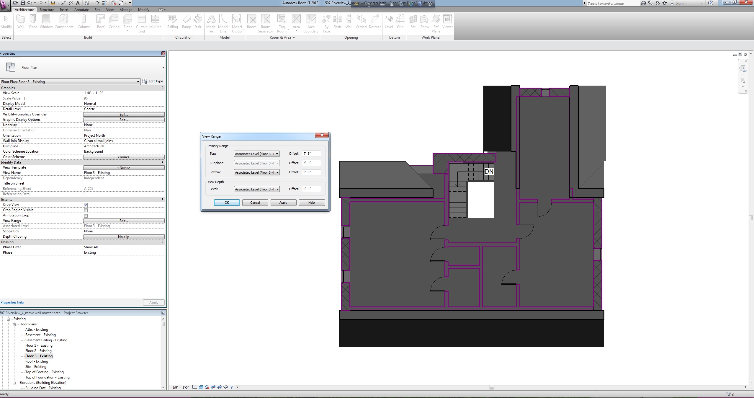

Hi,
I'm using Revit LT 2013 and working on my first model. I'm not sure why the third floor of my model is grey.  I don't believe my cut plane is cutting through the floor object (I moved the offset up and down just to see if anything changed, and nothing happened). The model display style is shaded, but that is the same as on the second floor, which shows up normally.  If I go to wireframe for model display style, then the floor is not shaded, but I'm not sure why the floor would be showing up as shaded if the  I'm attaching a couple of screen shots of the second floor and the third floor with some of the options opened.
Thanks for your help.  Apologies for the asking a beginner question.

Your second floor plan is set to Hidden Lines and it displays as expected, your third floor on the other hand, is set to Shaded so it displays as shaded. Change the 3rd floor plan Visual Styles to Hidden Lines and all should be good.
