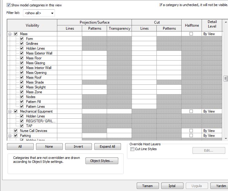

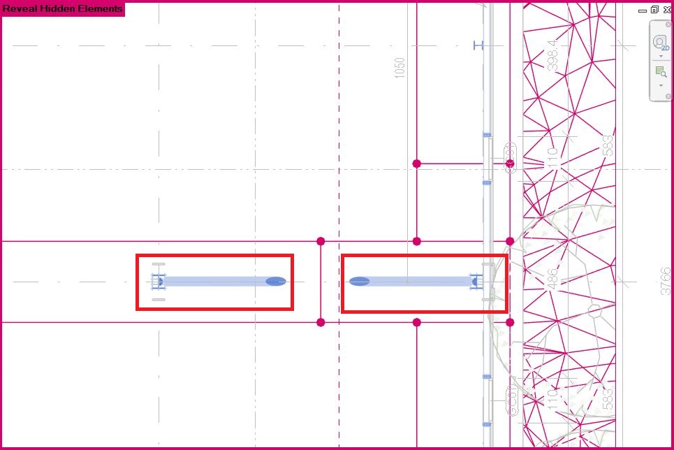

Hi,I was asked to import a 3d dwg into revit. I successfully managed it to cut it like a revit object in sections/views as importing it in a mass. But it doesn't show up in plans. When i reveal hidden objects, it can be seen somehow.Any idea?PS. Masses are on in view settings. ***SOLVED***View Settings - Imported Categories - Check the associated dwg
